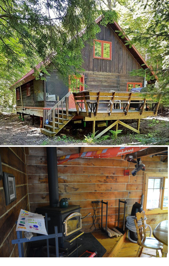

I have a specific question about log cabins. I found a log cabin that the person is basically giving away because he wants to build a big house. This is a square log 24 x 32 with a loft. I am interested in dismantling it and reassembling on my land
He is the 2nd owner and as used it for 30 years and says it is about 50 years old in total.
When I research on the Internet they say most log cabins "last" about 50 years.
I'm going to visit this weekend from the photos it looks in very good condition especially from the inside.
My one concern is that he said in his 30 years he really didn't do anything to the outside.
So when I go to visit besides obvious rot I'm wondering what would disqualify this as a good idea to disassemble and reassemble on my piece of land?
I'm somebody who has renovated homes but know nothing about log cabins
Here are some photos https://app.screencast.com/xDxlzDTjSIoc6
any ideas or advice would be greatly appreciated

Based on those pics, if it's basically being given away, and it's truly afforable for you to move, take it and run. That looks to be in very good condition for its age, whether the exterior was maintained or not.
Yes, look for rot and any major insect or animal damage. The thing is, as it's reassembled, you can replace a piece here or a piece there as needed, too. But, at first glance, that doesn't appear to need any major work at all. Make sure you're not being scammed. If it's too good to be true.....

It would appear to be fine. You could probably tell more by looking under it. We also have a log cabin. Love it and enjoy it.
