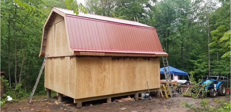

12' would be your span of the floor joists? That seams like to much to me. How many screw piles are you planing on useing for the 32' girder?
I just did 12in sono tubes for a 20x32'. Tubes go down to below frost up to a tripled 2x12 pressure treated girder. Sitting on that is 20' 2x10 for floor joists. The floor is very solid and I have no bracing under the cabin. The girders hanging below the siding dosnt look odd to me but you can always skirt the foundation. I dont plan on skirting mine.

Your setup looks great, and definitely doesn’t look odd. Are your beams set in a few inches? I had mine setup to be right at the end to carry the full load. Inset for weather protection and skirting does look better though.

My 12in sono tubes are pulled in from each wall by 12in. Making the beam and floor joist hang out by 6in. My girder goes all the way out to support the last floor joist.
I wouldnt span 14' in any floor with even 2x12. You need to come up with a plan so the breaks in your girder are over a screw pile. Useing 16' and 8' lumber and putting piles every 8' should accomplish this.
