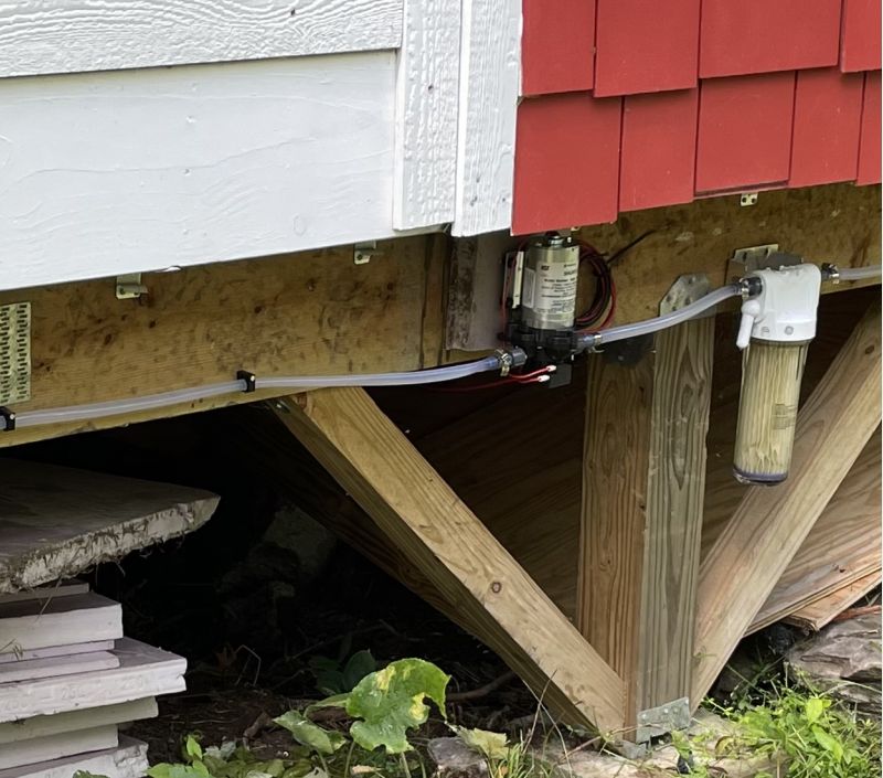

I actually just encountered this rv pump noise problem this weekend… so I’m following to see what you come up with. To be fair, I did mount the pump to the beams that support the cabin- I figured some vibration would happen, but it is louder than I’d like. Sometimes you can’t really hear it, and sometimes you can- really just depend on how quiet it is outside at the moment. The one nice thing is you can tell when it’s working.
I tried mounting to a 2†piece of pink foam insulation but that didn’t seem to make all that much difference.
2 options I’m considering is moving it off the cabin entirely, and/or looking into anti-vibration bases/pads.

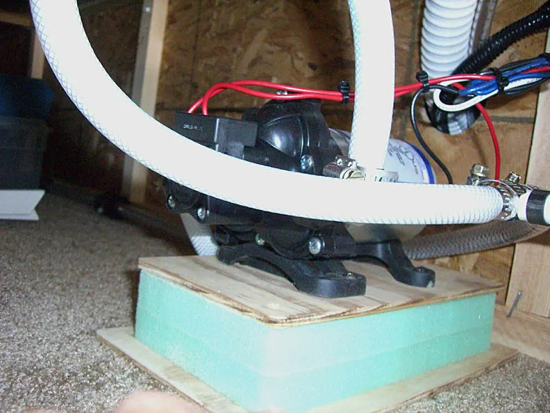

A common solution used by RVers is a DIY vibration pad. Essentially 2 pieces of plywood with soft foam (like mattress foam) glued between them. Make the bottom piece of ply larger so you can screw it down, then screw the pump to the top piece. The picture should make it clear.
Second, you NEED to change how the pump is connected. That PEX will transmit a ton of noise and vibration. Amazon sells pump silencer kits (just flexible hoses) that people use. Make a HUGE difference.
Third.. Where the pex is running along the joist, I would put it in pipe insulation and not have it in direct contact with the wood. Instead of those nice plastic clips to secure it, just use zip ties with a screw hole.
With those 3 things done, you will struggle to hear it.

No PEX- its Vinyl tubing. I didn't have the tubing attached to the frame at all at first and noise was the same... noise hasn't changed with the addition of fastening tubing to structure. .
I will definitely start with the pad and look into hoses- they seem to be more or less the same hoses as like a toilet or washing machine??? . I'm guess the flexibility of these hoses dampen the vibration so that its gone by the time it reaches the PEX or other semi-rigid tubing...I would think 100% nylon tubing would kill the vibration the same as these do ? ... but will definitely check it out- Thanks again
