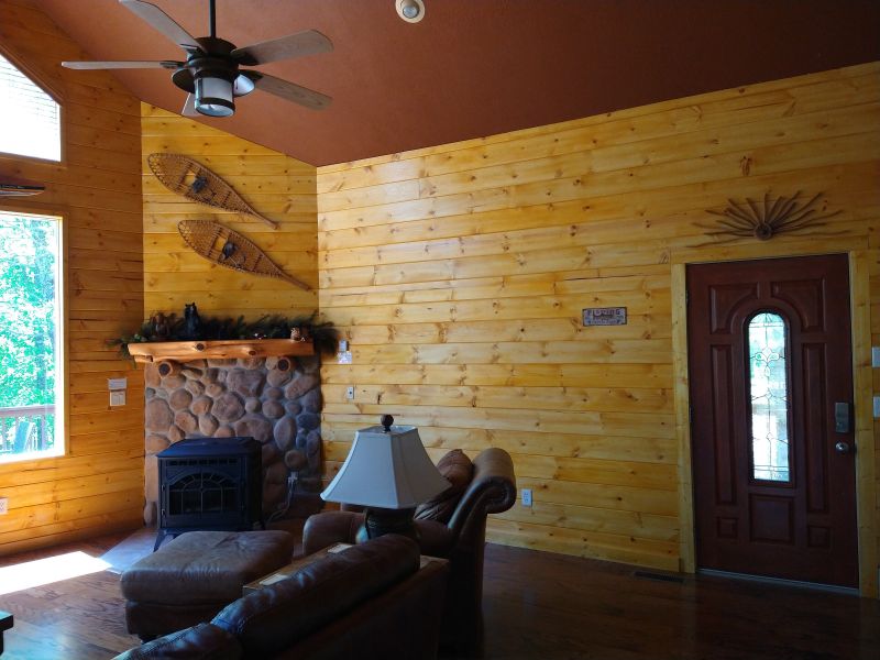

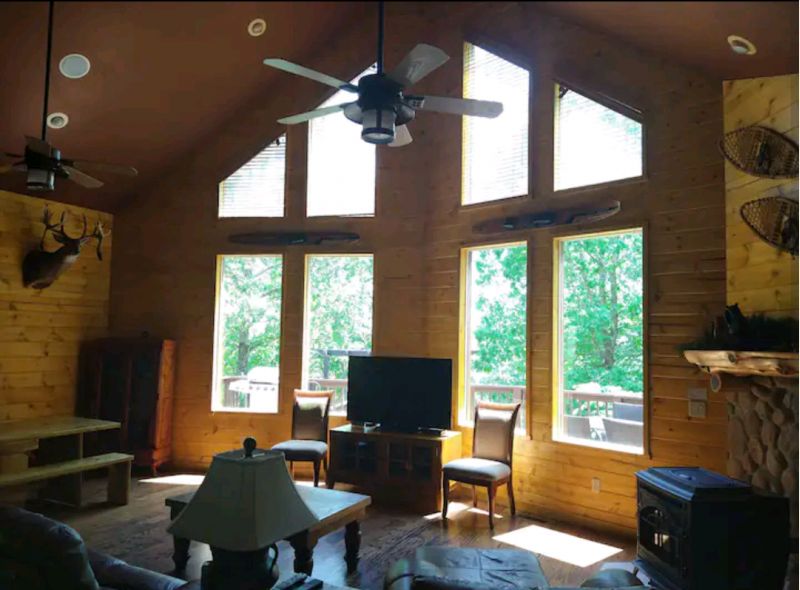

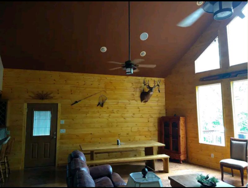

Hello again. I posted about this a few months ago. I had asked what the norm is that most people are finishing their pine tongue and groove walls with. I know a lot of people clear coat it and others stain it. Our cabin came with sheetrock but had stained wooden interior doors. We tried to match the doors and decided on Shellac Amber. I applied one even coat of it before it was installed on the walls...the carpenters had agreed to squeeze us in and they were coming in 3 days to put it on the walls so I got one coat of Shellac applied on the saw horses to save fighting a ladder later on. Now that its been installed on the walls, I'm not exactly happy with the results.
I'm debating whether a second coat will even give me the results I want. I've attached pics of it. It turned out too yellow for my taste, even though golden yellow is what we were going for to match the doors. Some of it looks blotchy too and I found out later that a wood conditioner is sometimes used beforehand. We are going to have wood put on the ceiling soon too and will definitely get a experienced painter involved.
I see cabins ALL THE TIME that have yellowish golden walls that still have a slight white natural look, how are these usually finished???

Ime adding the amber (when adding color agents start light) was an expedient to getting some 'aged look' we wanted without having to wait an age.
Now that it is up and done it is what it is. I suggest it will grow on you? If you think not I cant imagine stripping all that for a redo!
Fwiw, I Love what yours looks like

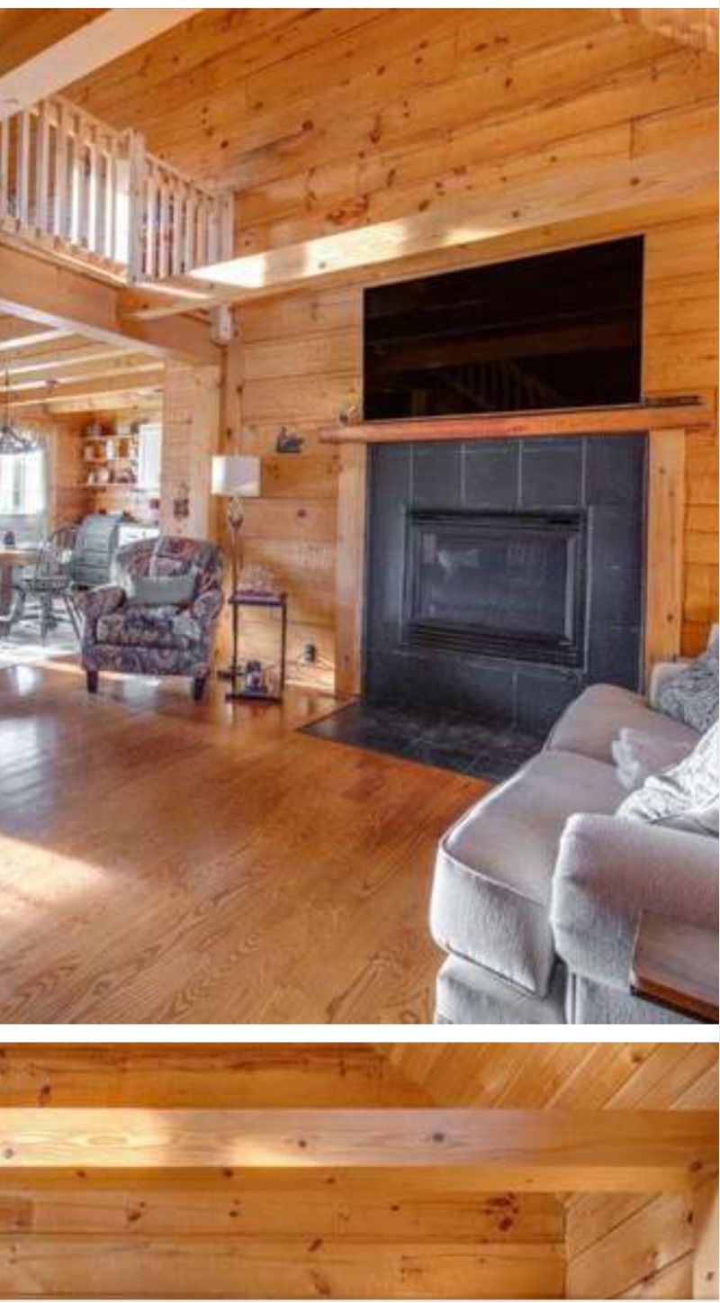

Thanks for the comments so far. The Shellac label said it won't darken with age so I didn't expect it to. Gcrank1, we've showed pics to a professional painter and he's coming next week, he thinks a second coat is all it needs to give it that complete finished look.
But still, I feel like we are missing something. On the sample piece that we applied 2 coats on, it looked to get quite a bit darker and turn a bit orange. I guess I'm seeing aged clearcoat when I see all of these local cabins in our area. Here is a pic of the cabin we almost bought but couldn't make a deal on. It was beautiful.
# Posted: 26 Jul 2023 11:35am
I can only speak for the Zinsser Brand shellac I used, now there are several brands with different make up but I never used them. The shellac itself does not darken but the pine does. It also seems that formulas may have changed a bit because raw shellac is very costly.
