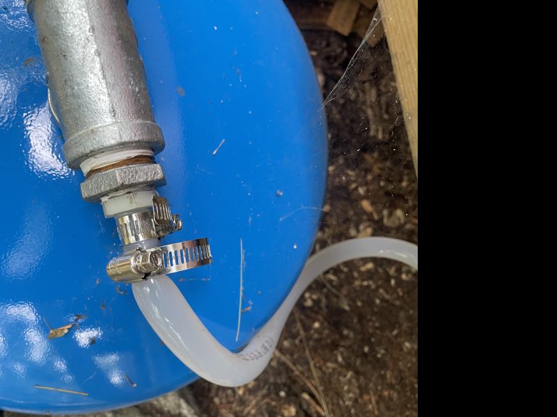

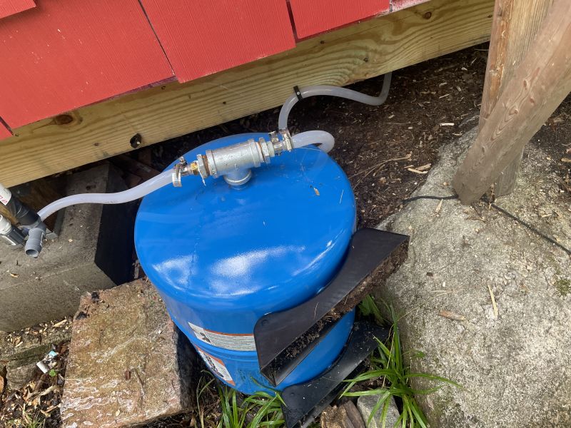

Thought I’d share this. Kind of funny.
When I put my water system in, I made a mistake with the tubing. I THOUGHT I had read the acceptable PSI limit of 1/2 vinyl tubing… but now when I go back and look - everything I can find says 45 psi working, 55 max…Whoops!
My system is 55 PSI.
I came back to the cabin this weekend and the water lines looked like stuffed sausages. Lol.
It’s all external anyways so no big deal. - this was more of a temporary “proof of concept” anyways. I had planned to redo the lines next year- and all I’m out is a $20 roll of tubing.
Do you think it’ll burst? Or do you think itlll be good till winter at least when i drain it in a few weeks?

Wow, that doesn't look good! With all that line expansion, you could almost do away with the tank!
We've got a similar setup, with jet pump and 5 gallon pressure tank under the cabin. It's all plumbed with poly pipe and hose clamps. Poly pipe at the local building store is either 75psi or 100 psi rated, so either should work for your application.
If you are hoping to get it to last until end of season, why not crank down the pressure so you still have running water, but stay a bit below the pressure rating of the hose? Here's a link to show the method of adjustment.

In the end…It did not burst… just grew to 3/4” tubing.
I was up today and winterized it. I just cut all the tubing at the connection points for the winter( I will replace next year) I drained the rv pump, drained the pressure tank, drained the main pump lines, pulled the foot valve of the main lines, and pulled them out of the lake.
The lake water is still in the upper 50s… but freezing temps are just around the corner I’m sure.
We’ll still get another month out of the cabin, but will haul water until winter.
I might run new lines yet this year, even if I don’t actually hook them up to water yet. I mean, being under the cabin when Allthe bugs are dead is a lot more fun than in the spring. Lol
I think I might just run copper lines under the cabin instead of tubing or pex. Not that much more difficult and sweating joints is super easy. Thought about galvanized steel but copper is just easier.
