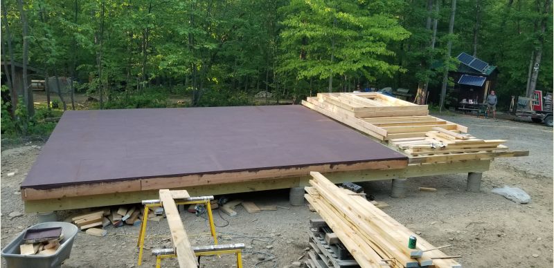

To get around useing expensive subfloor on my build I ended up useing non tongue and grove 23/32 OSB and found someone localy selling old Behr deck over paint. I layed it on to thick it filled any gaps and even would hold water durring our rainy build.

I used standard 23/32 OSB from HD. No idea what brand.
It has stood up fine for the last 3 years. I have been under the cabin recently and it looks brand new. If you are planning to be weather tight sooner rather than later, then I don't think it matters. However, if you anticipate a big delay and the material could see significant moisture, then I would try to find the better stuff.
