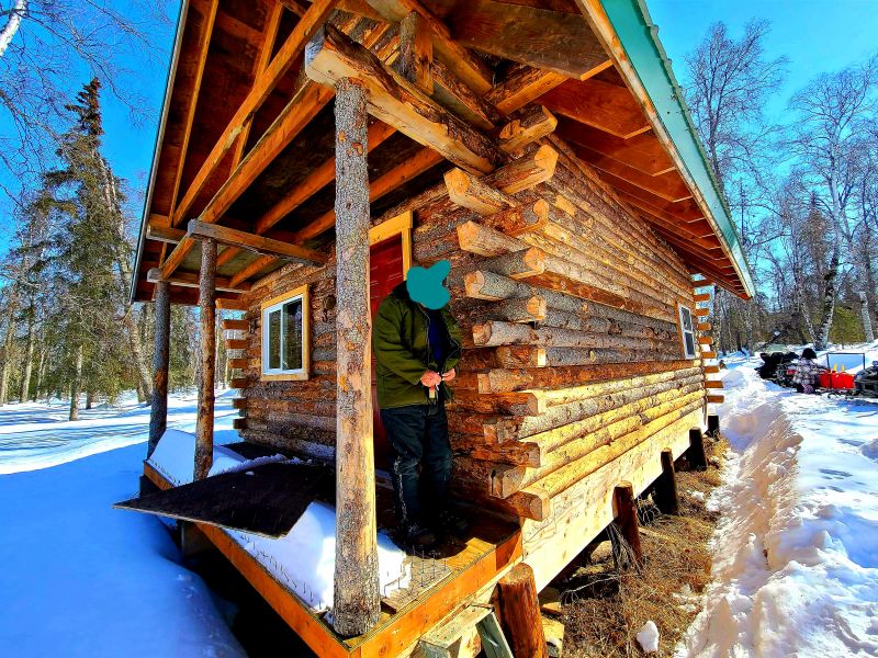

# Posted: 3 Oct 2023 10:13am
No if you are 36" off the ground you don't need p t wood. If you enclosed the foundation you may want a vapor barrier under your cabin. If it's open you should have enough draft. On our 16x24 we used laminated floor joists. BCIs. They are straight and easy to work with.
We also built a 3' overhang on the roof sides so that the drip line is away from the cabin and snow doesn't pile on the sides.
For foundation posts we used recycled utility poles. Treated cedar 4' deep. And cut a shoulder into them to hold the 6x12 joist bolted into them. Has been through a couple big earthquakes ,7.2 . And a lot of snow
Good luck n stay positive

Love that design! I've been trying to get my hands on some recycled utility poles to use, maybe incorporate them into my cabin design somehow.
Your cabin/site looks awesome (having checked out your journal). Thanks for the info!
