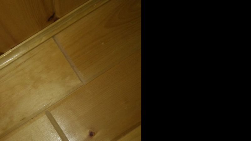

I did over 800 T&G Red & White pine planks. Shellac is great BUT there re several caveats, I used Shellac & Poly depending on location... kitchen, bathroom are poly for obvious reasons.
I rolled the poly with small speed roller.
Built a rack with 2x3's, with 4" between and laid all the planks to dry on there - reused the 2x3's for other project that followed after. (screw it together so you don't waste anything)

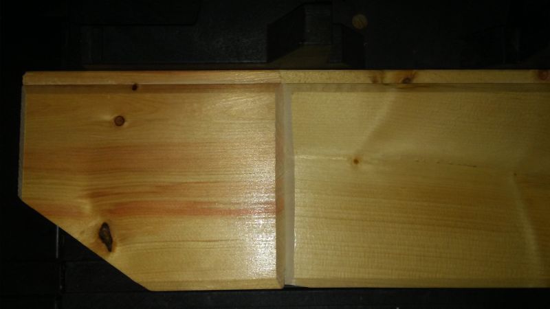

Do remember to coat teh joint areas. Some folks put butt to butt but I made a V-Groove cut so when boards butt together there is a nice groove instead.
V-Joint butt in-situ
example with 45deg cut.

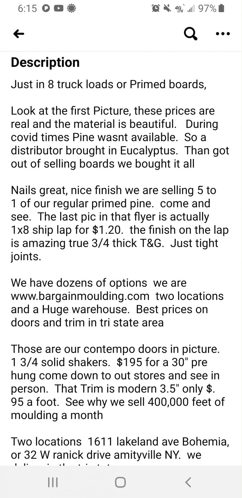

# Posted: 5 Nov 2023 06:18am
Came across this on Marketplace today.
So someone does sell primed tongue and grove. Theres a website there so maybe you can find a more local supply house.
