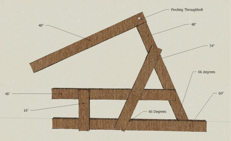

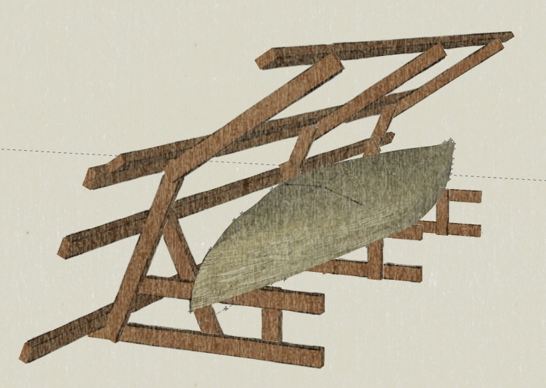

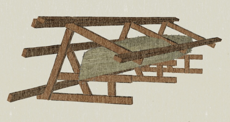

Grizzlyman
# Posted: 7 Nov 2023 03:04pm - Edited by: Grizzlyman
Something like this possibly… not sure if it’s overkill…
# Posted: 7 Nov 2023 03:56pm - Edited by: ICC
looks like it would do the job. Sufficient overhangs at the ends to block the AM and PM sun?
