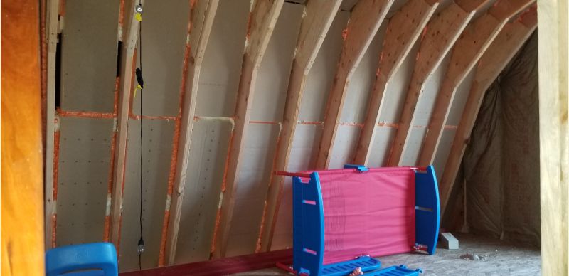

This weekend I used 4in thick foam board to insulate the loft ceiling/roof. I greatly under estimated the amount of canned foam I would need. Didnt help that my framing in areas didnt allow for easy cuts of foam. I'm 16 24oz cans into it and half done. I should have just bought a smaller DIY spray foam kit.
What I really should have done was to just put the foam between the perlins and roof rafters..but it rained our whole build.
