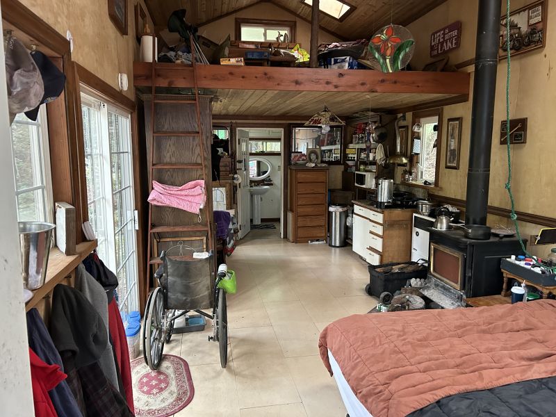

We did a 12x24 and a 12x12 stand up in the center loft on our 1st build; used it for 30+years, a good size for 2 of us. Our reality was that the loft bedroom wasnt that great. Up/down got old fast (ladder as it was too small for a stairs) then impossible after some injuries. It was beastly, sweltering hot on some summer nights even with cross ventilation. In winter it was snuggy warm until it was cold, then I was going down the ladder to load the stove again (if you figure on a wood stove know that it is not likely you can get a size that will run all night on a bedtime fill in a small cabin).
My conclusion is that a loft in a small cabin is better used for storage of 'seasonal' stuff, etc than people space. My current, or next one Im contemplating only a max 3' 'loft 'shelf' so stuff doesnt just get out of reach/buried back in it.
We have found on the current one that the 16x24 open room, cath ceiling is about the same sq. footage but so much more usable. A bedroom could be partitioned off but we use futon couches that turn into beds as needed. This footprint also is better at the whole room heating from one stove, but we still have to use a fan to kick the air around to get the mix. A cabin long and narrow will have cold ends if the stove is central or one very cold end if heated on the other end.
