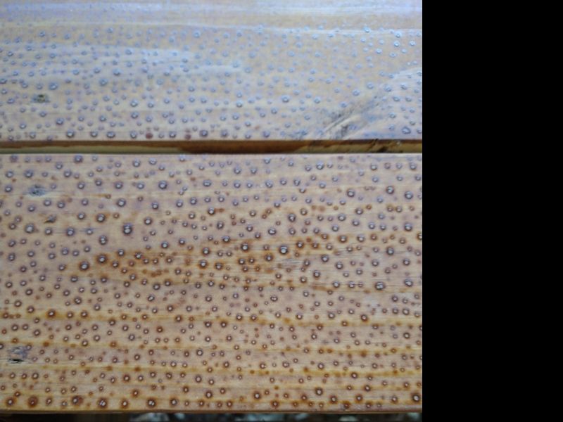

Hello everyone. We had a front porch added to our cabin about 8 months ago and I recently stained it. The guy at Sherwin Williams recommended using a roller to make the job go faster. I ended up using a brush for most of the job since there were so many tight places...I used the roller on the ceiling and it worked fine with only a few minimal bubbles, most went away and only a few left dark circles. However, on the floorboards, I have a living nightmare.
I done about a 4th of them before realizing the bubbles wasn't going to go away. Even when trying to apply the stain thinner, there were still bubbles so I took the brush and smoothed out what hadn't dried and finished the other boards with a brush too.
Now I'm sanding the terribly spotted boards. It's been 10 days since the stain was applied and my sander is still gumming up from the stain not being fully cured. I'm in Arkansas and our weather has turned cooler since the stain was applied. I can keep using a wire brush to unclog my sandpaper...thought of renting a floor sander but the guy at the rental store said it would clog just the same. It's a huge front porch (10x50). Also considering stripper or pressure washing to help before sanding. Thoughts?

# Posted: 27 Nov 2023 09:24am - Edited by: ICC
Yes, talk to the person or their manager. But at this point removal is the real solution.
The problem may have been the new wood used to build the deck. Pine and cedar can have what we call a "mill glaze". This can develop when the surfaces are run through the milling machine. The cutting knives get hot and can cause sugars in the wood to create a surface glaze. Stains will have trouble adhering to that.
New wood should be either sanded well or, preferably, cleaned with a wood deck cleaner/stripper followed by a light pressure washing. Sometimes scrubbing the wood with a stiff bristle brush is necessary before the pressure washing.
After the wood stripper has been applied, scrubbed and pressure washed, apply a wood brightener. This will allow the wood pores to open up and the stain to penetrate the wood as it was intended. Light sanding may be needed as the cleaning may create a "fuzz".

# Posted: 27 Nov 2023 10:00pm - Edited by: ICC
Got a picture or two of the problem effect?
-izzy

# Posted: 28 Nov 2023 09:09am
[img=null][/img]
Tim_Ohio
# Posted: 28 Nov 2023 09:40am
You might try applying the stain, then wiping it off with a rag. This will take off any residual that would bubble up on the surface.
In it’s present condition, try using a rag with the solvent suggested for thinning it and see if it might dissolve and smooth out the appearance.

# Posted: 29 Nov 2023 10:11am
It does look like the wood didnt absorb much of that stain for some reason. Is the temperature correct to use the product?
I have applied a quality oil based stain over green rough cut wood and it would have taken a second coat if I applied it.
Did you back brush like your suposto?
