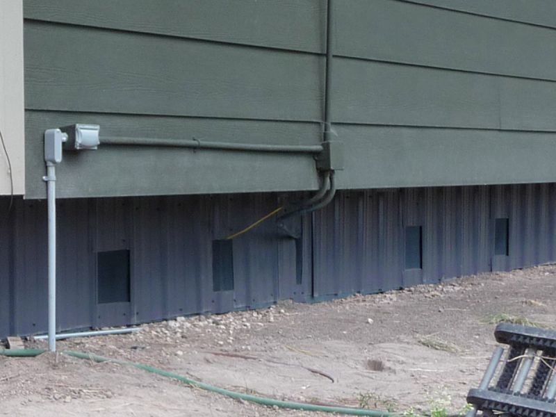

I have used ribbed metal roofing panels. The same style as the roof but in this case a different color. My roofing vendor will cut the panel stock to any length
In the image below one can see that I cut out squares at the edge of each panel segment. I used strips of butyl flashing material on the inside face to secure the screening material. Just off hand, I forget the name of the screening. It has a fairly fine opening and is steel wire rather than aluminum as used for many window screens. The wire gauge is heavier than the window screen material.
PT 2x4 runs along on the ground level between the wood piers. The metal panels are screwed to the ground level 2x4, the PT piers and the foundation beam.
FYI, the underside of the floor overhang is sheeted with galvanized steel roll flashing. Combined with the skirting and cement fiber lap siding there is nothing combustible. I installed it with a couple of panels framed for easy removal in case access was needed. I do not store anything under there.
No rodents or insects have ever been seen. No mold.
Aim for a minimum of 1 sq ft or open screened vent for every 150 sq ft of floor.
This was installed in 2012, looks the same today.

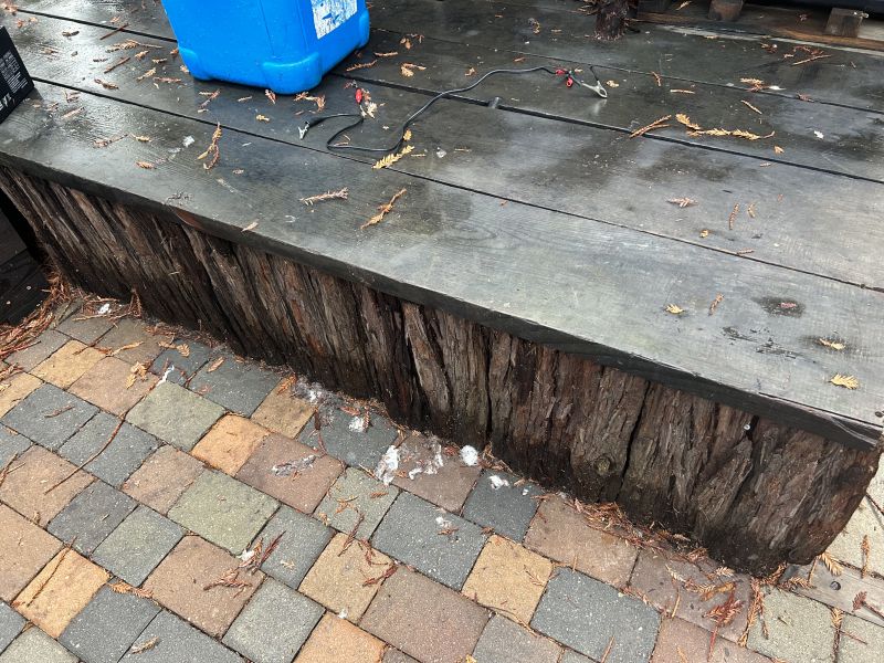

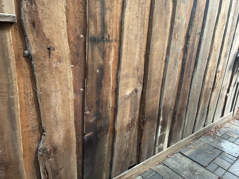

I milled my live edge siding to go all the way to the ground with a trim board. About 16” of crawl space. In front where the deck is, I just used leftover bark millings held on with one screw each. To work under the cabin I take a couple out and shimmy under.
