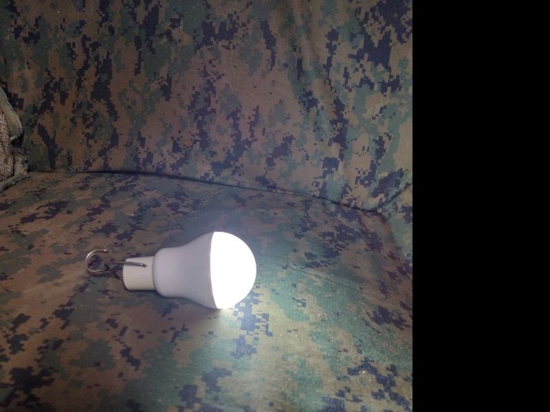

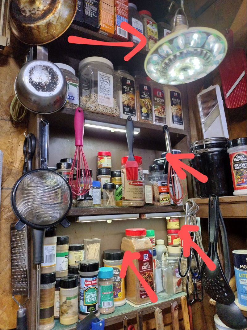

Here's a couple that we use. The little bulb ones run or recharge off USB. Really handy to move around if needed. We hang them on the sunbrella at nite.
Under cab and E26 base
Little USB bulb
Little USB bulb
