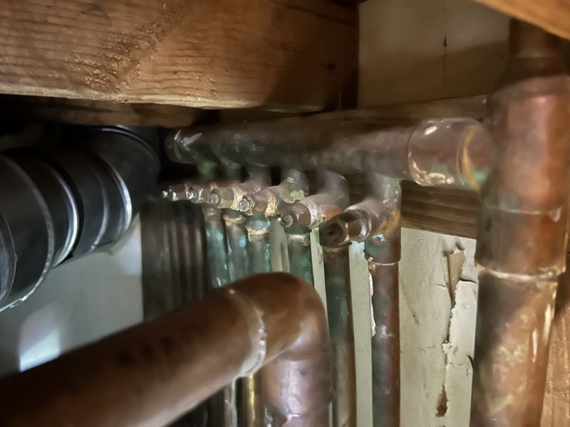

Quick question. And sorry to butt in.. I want to turn off some floor heated sections at my city house, but when I loosen these lock nuts the screws just spin around, thought they would be needle valves. Could they be half turn blockers? Can’t remove nuts or water pours out.

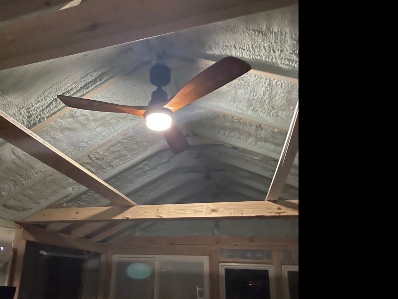

I have 2 ceiling fans in the 16x24 room cathedral ceiling to move it around. It circulates the heat put off by my mini-split right now.

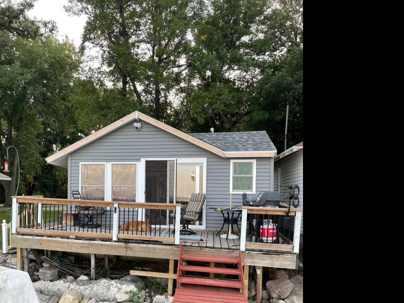

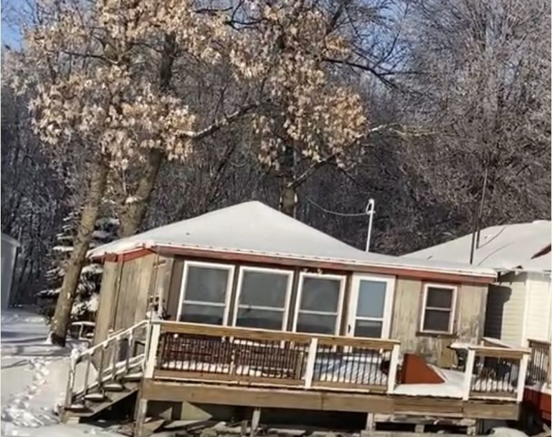

Here is the before and after of the cabin and the spray foam with a ceiling fan. Pretty close together, if one goes up in flames about 5 more to the north will go too.
Cabin- before
Cabin- before
cabin after
cabin after
cabin ceiling
cabin ceiling
