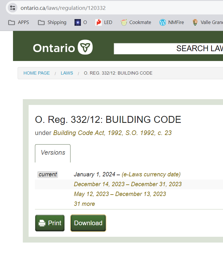

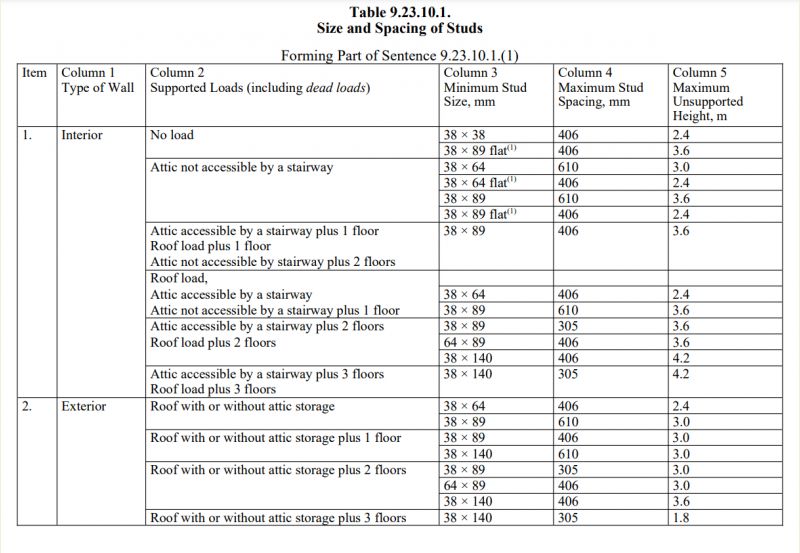

Steve, are you sure about those stud requirements? Table 9.23.10.1 from the Ontario building code (Size and Spacing of Studs) lists 2x4 as an acceptable stud size for several exterior wall configurations. I downloaded it today from https://www.ontario.ca/laws/regulation/120332 It is the first image below. The second image below shows dates.
It appears to be current. The document is downloadable in *.doc form from https://www.ontario.ca/laws/docs/120332_e.doc Or perhaps there is an update or an addendum I did not locate?
For those not into metric measurements, 38mm x 89mm is a 2x4, an actual 1.5 x 3.5 inches. 38 x 140 is a 2x6, actual 1.5 x 5.5 inches 38 x 64 is a 2x3, actual 1.5 x 2.5 inches Spacing of 406mm is 16", 610mm is 24", and 305mm is 12"
Column 5 indicates the maximum stud height without extra bracing. 3 meters = 10 feet.
Those figures are pretty much the same as set forth in the US IRC codebook.
It would appear that a 2x4 wall on 16" centers is structural code for walls supporting a roof with attic space and one upper floor.
IF we are sizing wall studs to meet the energy code with batt insulation in the stud bays, then we would need to upsize the studs, OR use some other form of insulation as I mentioned above.
