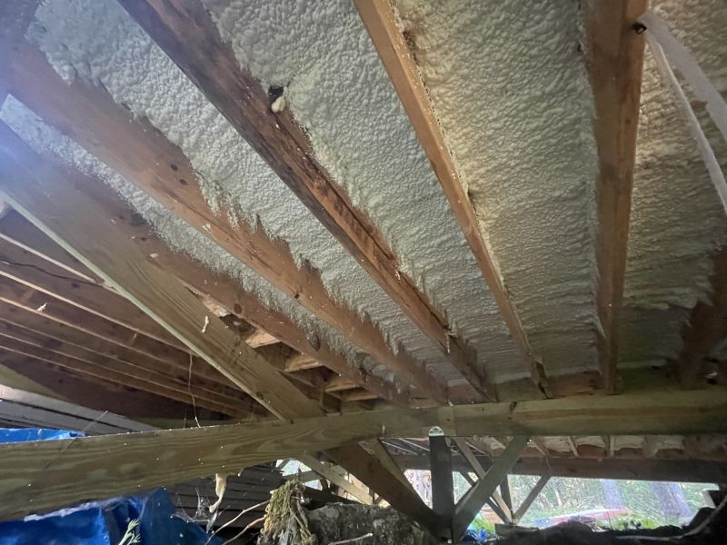

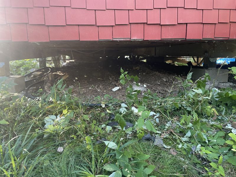

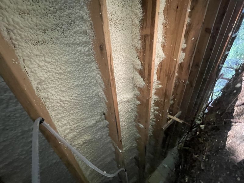

Done! Success! It was actually fairly easy. Only took about an hour. I was really dreading this but it was not too bad. think if you were using this somewhere else other than spraying overhead in a crawlspace it would have been a cinch. I had a little more room that I was anticipating. 2-3 ft in most places- Only one quadrant of the cabin had super restricted space- the other places were actually fairly easy to maneuver. Didn’t even get any foam on me- I was very impressed with The froth pak- it made for a very professional type job. Looks good and the floor just feels denser now too when walking on it. Not cold enough yet to tell if it’ll make a difference but should.
The 620 board ft froth pak just barely did the 440 sq ft. I’m sure it was maybe thicker than supposed to be in some parts- but I’ve got a good solid 1-2” of foam in most places. The 30 second spray time untill nozzle clog wasnt a big deal at all- in fact I only used 4 nozzles.
I learned that If you put it on too thick it will buckle at the leading edge as it expands and pull downward seperating from the subfloor. It happened a few times. I just let it dry and broke the edge off and resprayed in its place. a thinner coat and continuous wet edge is the best way to eliminate this but not always possible when having to reposition. There’s a few spots that need some attention yet. I’ll buy a can or two of the kraken foam to fill those in.

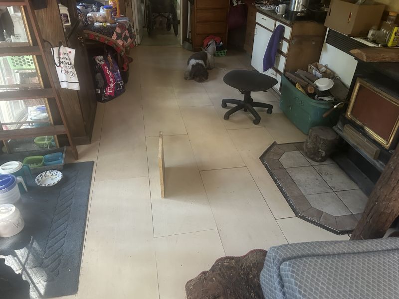

Been following this a bit since Griz brought it up. My place is just 3/4 ply over 2x joist about 16” off the ground. Pretty mild here, a few 30 mornings in winter. Would it do me any good? Not that I feel like farting around under there..
Over the plywood I have these particle board shelves I picked up free from a retail store that moved. They’ve held up well, hard as a rock. Probably insulate some too. It’d be easy enough to pull them up and put something thin under. Or I have some old thick throw rugs from the city house.

Just reporting on the benefit of floor insulation. Last weekend we had some pretty chilly temps (down to low 30s) though no freeze yet.
We had the stove going and noticed how warm the floor was. And not only that but the floor stayed warm throughout the night. In fact when I woke up at 6 the next morning the first thing that struck me was that the floor was actually warm when I put my feet down.
I think this proves the insulation project successful.
