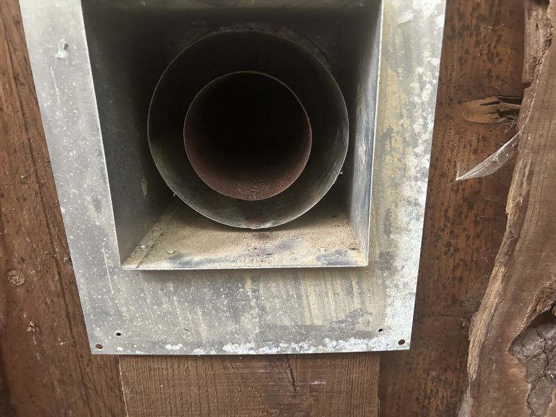

# Posted: 21 Feb 2024 11:16am - Edited by: paulz
Here’s mine from outside. Doesn’t the hot air go out through the center tube and cool air come in the outside tube?
