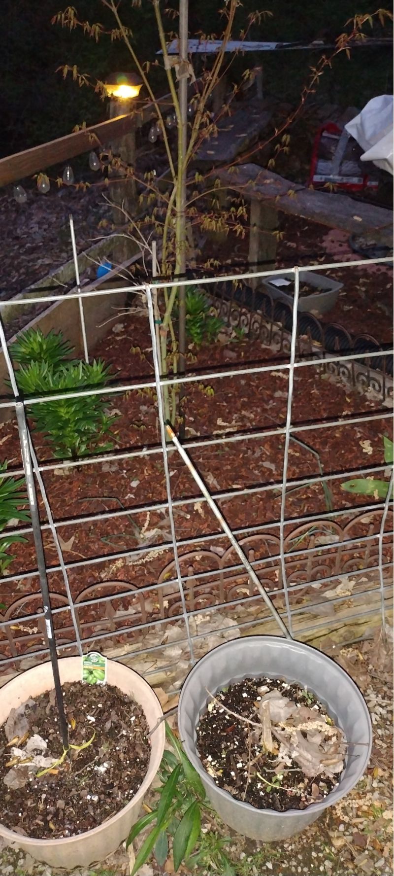

# Posted: 4 Apr 2024 08:56pm - Edited by: darz5150
You might consider cattle panels. You can bend, roll or shape them pretty easily. You could mount them to the floor with conduit clamps or even plummer's strap. They are self supporting as opposed to hurricane fencing.
I use them to keep my visiting families dogs out of the wife's flower beds.
