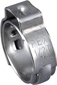

The stainless cinch crimps. Like these.
You can buy a starter kit with the crimp tool, pex cutter and 20(or so) rings for like $30.

# Posted: 12 Apr 2024 09:27am
Quoting: travellerw
After the 08 recession I started buying foreclosed homes, many of them were not winterized and had broken waterlines....
I ended up replumbing many of those homes, all using PEX and these clamps. I also plumbed my cabin with this setup. I have had 0 issues with leaks since then....

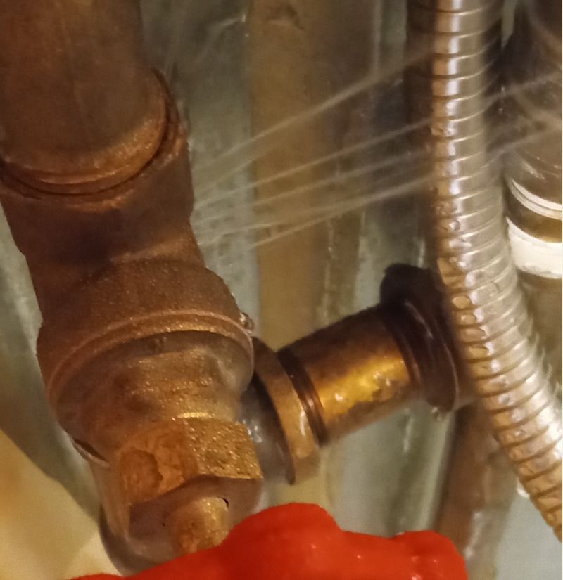

A BAD Lesson learned with more recent Brass Products like vales etc... Sad to say but they are not what they used to be... I have had 2 valves (twist type) fail, 1 in 1 yr, another in 3. BUT it is the brass that Cracked along the side and started spewing water... This is not the only cast/machined brass items that I have had problems pop up with.
See Photo Source of Valves: Home Depot.
cracked valve
cracked valve

# Posted: 14 Apr 2024 09:06pm - Edited by: Steve_S
That isn't a Pex Valve. Located inside the house as part of my shower setup. Never frozen or subject to any kind of abuse.

I prefer ball valves except for one particular situation. If a ball valve is used in a location that may be subject to freezing temperatures I don't like ball valves if there is any chance the valve may be left in closed position. That can trap a little slug of water that will crack the brass body if a freezing temperature is encountered. If the ball valve can be left open or if you or whoever is certain to drain the water before re-closing the ball valve nothing bad will happen. But brain fade can set in and the result can be a cracked valve body. I found out the hard way a few years ago.
Other than that I love ball valves.
