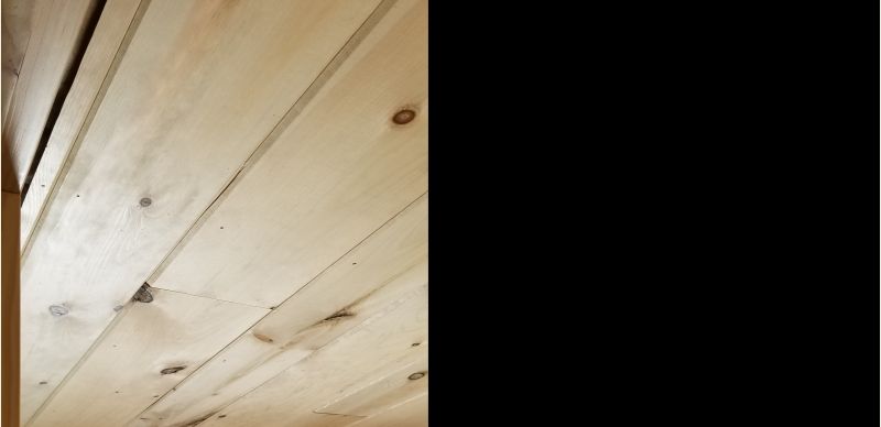

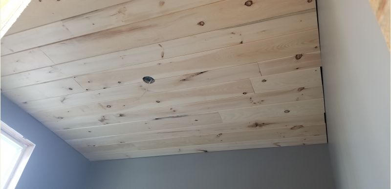

I knew my pine T&G ceiling would need to be trimmed out where it meets up with the drywall. Quick google search and i found a good idea to handle that (not my ceiling or cabin, just images i found online with similar situation):

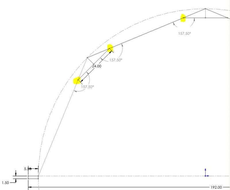

However, last time i was up i noticed the T&G must be shrinking a bit as there is a noticeable gap where the ceiling transitions angles as it wraps around the underside of the gambrel roof angles. The angle is 157.5 deg. I thought about getting some pine boards, maybe 1.5" wide or so by 1/2" thick and cutting angles on the edges so that it was something like a crown molding, but with such a large angle like that, the piece would end up being super thin.
Another idea was some thing 1/8" or so strips, again 1-2" wide and lay that over the seam. This idea is going to be tough to keep it running nice and straight over the 32' length of the cabin as it won't really have a good way to nest into that angle. It would have to be eyeballed with a laser level or something.
Ideas?

Brettny I agree with the 1x4 idea and look, however in those 157.5deg bends, putting a 78.75deg angle on each edge doesn't leave much meat left to that 1x4. Make sense?
# Posted: 12 Apr 2024 12:09pm
Yes that makes sence. You could not cut it to a sharp edge. Say cut the angle to where theres still 3/8 of square edge showing.

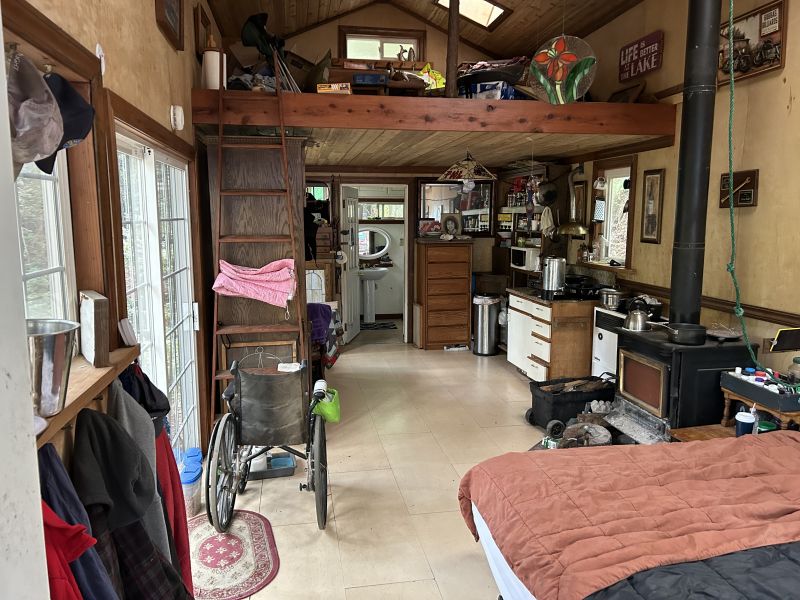

Wow that’s a good idea Ak. I’ll have to remember that. But being a cheap sob, mine is trimmed with free stuff a pal had left over from remodeling his house. I put it everywhere, ceiling, skylights, doors, windows, floor, panel seams..
