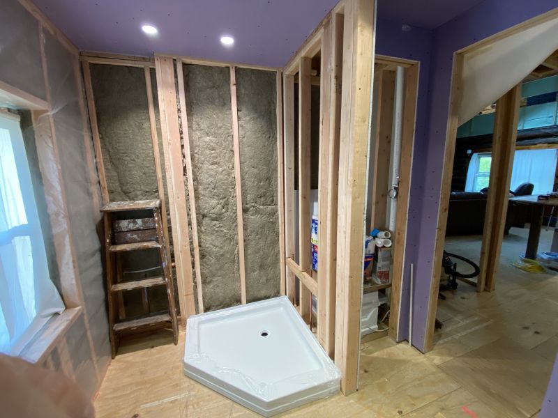

Hi Fellow Cabiners-
I'm finally getting to building my bathroom and would love some design suggestions from you's guys (as we say here in Jersey).
Bathroom is 8'x8' for all intents/purposes. I originally planned for an bath tub but was convinced to go with a neo-angle shower so the room is already different than my original 'plan'.
My ask today is what to do with the ceiling. I could just stick with painted drywall then thought 'how boring' that'd look for a log cabin (despite the drywall on the walls).
Option 1 is to re-purpose some of the MANY 3/4" tongue and groove boards I have left over. I have a lot. I have a few concerns with this option. a) each board is coated in 3/4 century of cigarette smoke film. b) they're shellac'd - before I can even apply some sort of clear finish over the boards, I have to diligently scrub each board down to get the nicotine film and the old shellac off. It's not the end of the world but a lot of work. Then the question becomes, what do I top coat the boards with for a bathroom ceiling that'll be exposed to moisture? I'm thinking oil-based Polyurethane or maybe Spar Varnish (i'm not familiar with the product other than I know its used for exterior use)? I'm not a big fan of Polycrylic and I think shellac (albeit probably the easiest) might have issues in the future from prolonged moisture from the shower.
Option 2 I came across an idea today to use 1/4" tongue and groove cedar (the paneling kind you can get at the orange big box store). I don't think I can afford 3/4" cedar. - again the question becomes what do I top coat the wood with? Do I even top coat cedar? Has anyone used 1/4" board before and does it warp over time? Again, prolonged moisture might cause issues. Any thoughts on how to finish the corners around the room (where the ceiling meets the wall? - I don't think they make cedar bed or crown moldings at least without going to a specialty lumber yard).
Option 3 was to use vinyl tongue and grove boards but this limits me to only white. What do I use to glue the vinyl to the ceiling? Vinyl would probably be the best choice for moisture/ceiling.
Any other input is greatly appreciated. I'll post a picture of the current bathroom space for reference.
Thanks!
Bathroom
Bathroom
