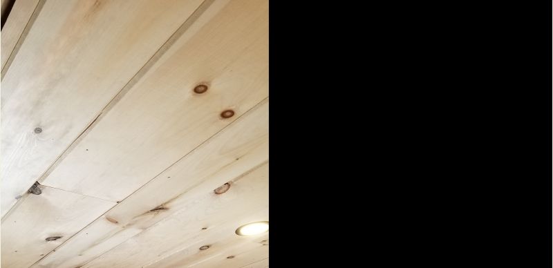

I used a $60 HF airless sprayer and sprayed this on white pine tongue and groove. I did one coat on the back and flipped immediately then one coat on the front, let dry for 5-10min then did a second coat on the front. No sanding or any surface prep. I could have sprayed a whole pallet load of the boards before lunch if I had enough saw horses.
Idk how it's going to yellow or last because I just did this about a month ago. The satin looks like you didnt put anything on the wood, just what I wanted.
I also did a few doors with the same finish but sanded with 400grit between coats. I did this because I wanted the finish to be smooth to the touch

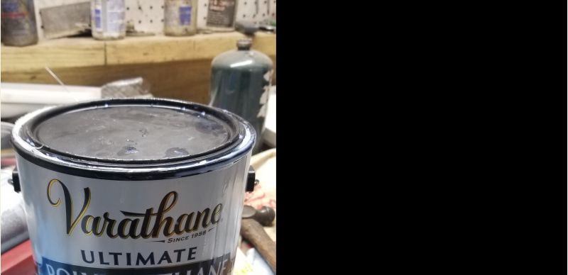

As a guy that has used a lot of topcoat while operating a custom woodworking shop. Varathane brand polyurethane is my choice. I have used both water borne and petroleum based. Both work great. But I believe that the petroleum based product goes on smoother, easier. I have heard folks say polyurethane looks like it is dipped in plastic. I don't believe that. It is very durable and provides the best moisture resistant qualities of any topcoat. As for yellowing the wood. Pine will develop a yellowish tint through the years that is caused primarily from sunlight, UVs. And personally I like that look. Most important for TnG is to finish before you install. Wood moves and you can notice the difference when it shrinks a bit in the dryer months.
For our TnG pine boards I will spray the back and then the front. And reapply to both sides again. Using a green scotchbrite pad between coats. It takes a little more time but I want the best I can do.
