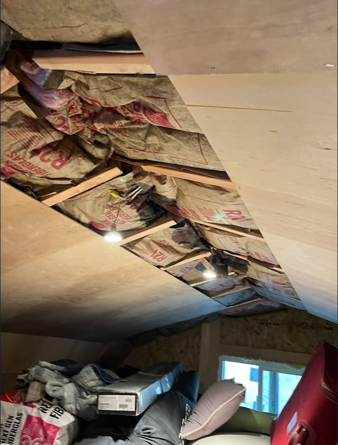

I need some help here. I have a 12x24 shed with a half loft, that I turned into a home. It is set on a slab. I am in northern Idaho and deal with the PNW humidity. I am off-grid, run off of solar and generator power.
The photos below will show you most of my issue. My ceiling is dripping wet! I have had this issue since spring officially hit and the sun bakes the roof all day after a night of being chilly outside and warm inside. I open all of my windows during the day to get more airflow, but that is not enough. I have to run a pretty high-powered fan all day to make sure the ceiling doesn't start getting wet. Even then, it can be an issue.
I have not cooked inside or showered inside in over a week. I have not used any heating inside for a couple of weeks (it gets pretty hot in here during the day). The RH in the house stays below 50% at all times according to the gauge I have.
What do I do? I have a few ideas. Let me know what you think...

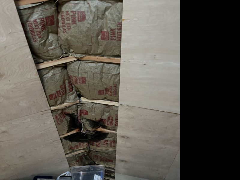

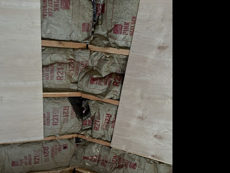

OK, from the photo's this is what I see with a few assumptions.
1) Roof Appears to be built using 2x4.
2) There appears to be no space allocated between the insulation and roof sheathing, there should be.
3) There does not appear to be any Vapour Barrier between ceiling finish & insulation. There should be.
4) Appears that the insulation used is Fiberglass. I HATE FIBERGLASS, it holds & retains moisture, provides a lovely home for bugs & rodents - Rockwool (like Roxul) is the best, alternately spray foam which also makes it's own Vapour Barrier.
What you have here is commonly called a Sick House with a HOT ROOF due to lack of ventilation & passive design. An HRV or any other "system" will not solve this.

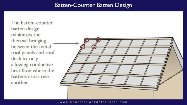

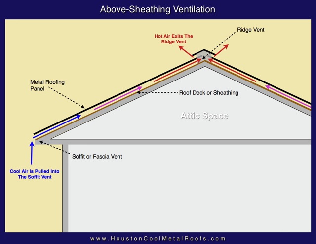

Yes a Cool Roof system where the tin is removed, roof strapped & cross strapped to allow for 1.5" airspace along with Ridge & Soffit vents to allow natural convection to keep airflow moving & providing a thermal break. This does make a house difference in and prevents Heat Gain & Loss through the roof. SEE ATTACHMENTS

sheathing vent
sheathing vent
batten counter-batten

Short of a roof leak this boils down to poor insulation and poor air sealing on a cathedral ceiling.
With 2x4 or 2x6 rafters you really cant get a proper air seal or enough insulation in that ceiling unless you use spray foam. You can try to put baffles in and vent until your blue in the face but you may just be making mold in your attic. I would take it all down and spray foam it.

Screw 2x4 spacers to the roof going from drip edge to peak every 24”. This will create a channel. Then go back and screw 2x4s the other way perpendicular to those going lengthwise. This will create your purlins. You can then screw your roof panels back to the purlins.
This creates a “cold roof” so temperature changes on the metal are evened out by the air anround it and the humidity from the house won’t condense against it. The channel will be an 1.5” which should be fine for a 6’ roof section. Due to the increase in “thickness” of the roof the panels the panels will probably be slightly shorter than necessary. Adjust accordingly.
