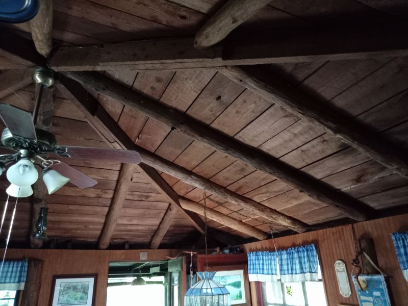

Fanman
# Posted: 26 May 2024 09:15pm
Is there already evidence of mold or other problems? If not you're probably fine.
Our cabin is the same; the visible (cathedral) ceiling is the roof planking (1" rough sawn chestnut boards on log rafters). We can see the roofing felt through the gaps. No problems, though the cabin is well ventilated, it's drafty and has lots of windows.
# Posted: 26 May 2024 09:31pm
Interesting ceiling fanman. Lots of character.
My personal opinion is that such a roof/ceiling will not generally be a problem for moisture condensation. It will not be very energy efficient, which does bother me, but probably not produce any major health or structural issues, unless there is very low air circulation and the surfaces remain damp or wet for extended periods.
How old is the cabin, churl? Are there any discolored areas that might suggest having been too wet previously? Have you seen areas with obvious condensation or are your concerns mostly theoretical?

Fanman
# Posted: 27 May 2024 06:08pm
Quoting: paulz Nice ceiling Fanman!
Thanks... it's original (1928). Zero R-value, of course, it was built a a summer place but with a good fire going it's quite comfortable in the winter.
Some of the neighboring cabins had the ceiling painted to "brighten them up", I guess, but it destroys the aesthetic... I'm glad nobody did that to ours. The dark wood does make it dark inside but the skylight on the other side helps a lot.

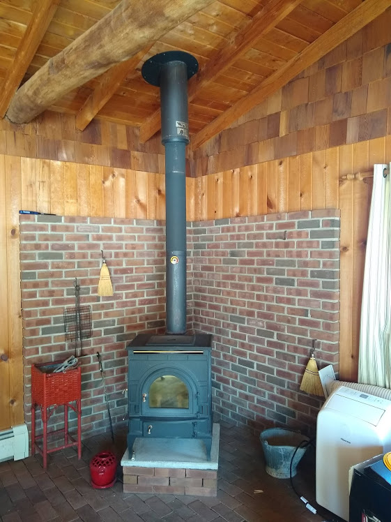

jsahara24
# Posted: 28 May 2024 07:10pm
The rec room in my primary residence has a similar situation..... cathedral ceiling, pine t&g boards on top of the exposed rafters, then 1" of foam board, layer of osb, snow and ice shield and shingles....
I have not had any issues with condensation. I do have a lot of issues with heat loss/gain....No issues in the winter with the wood stove in there, but in the summer its almost impossible to use air conditioning....
pic of ceiling.... https://www.small-cabin.com/forum/shared_files/uploaded/10402/143981_2_o.jpg
# Posted: 28 May 2024 11:22pm
If you have issues with heat/cool loss in that room then you prob have mold/condensation at your roof decking.
