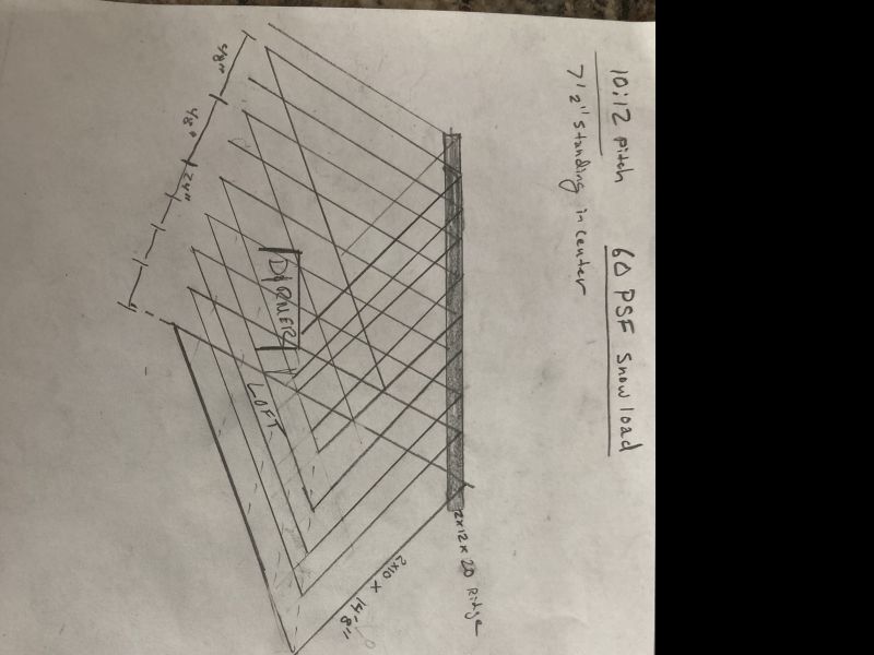

16x16 full scribe scandanavian saddle notched, out of red pine. Logs walls only, opted for a 2x roof system as this is a solo operation and will be moving it into the bush. Currently trying to flush out some details. I am a former mil pilot with a head injury..not a builder.
Looking at: 10/12 slope, 2x12x16 ridge, 2x10 24 o.c for first 8’ (loft w/ dormer) and hoping to figure out how to do 48ā€ for joists through the remaining 8’. Will use simpson strong ties at ridge and joist.

# Posted: 30 May 2024 04:45pm
Pic
jp0639
# Posted: 30 May 2024 04:54pm
Plan to plane the top logs and put down a 2x10 top plate for the birds mouth to rest on

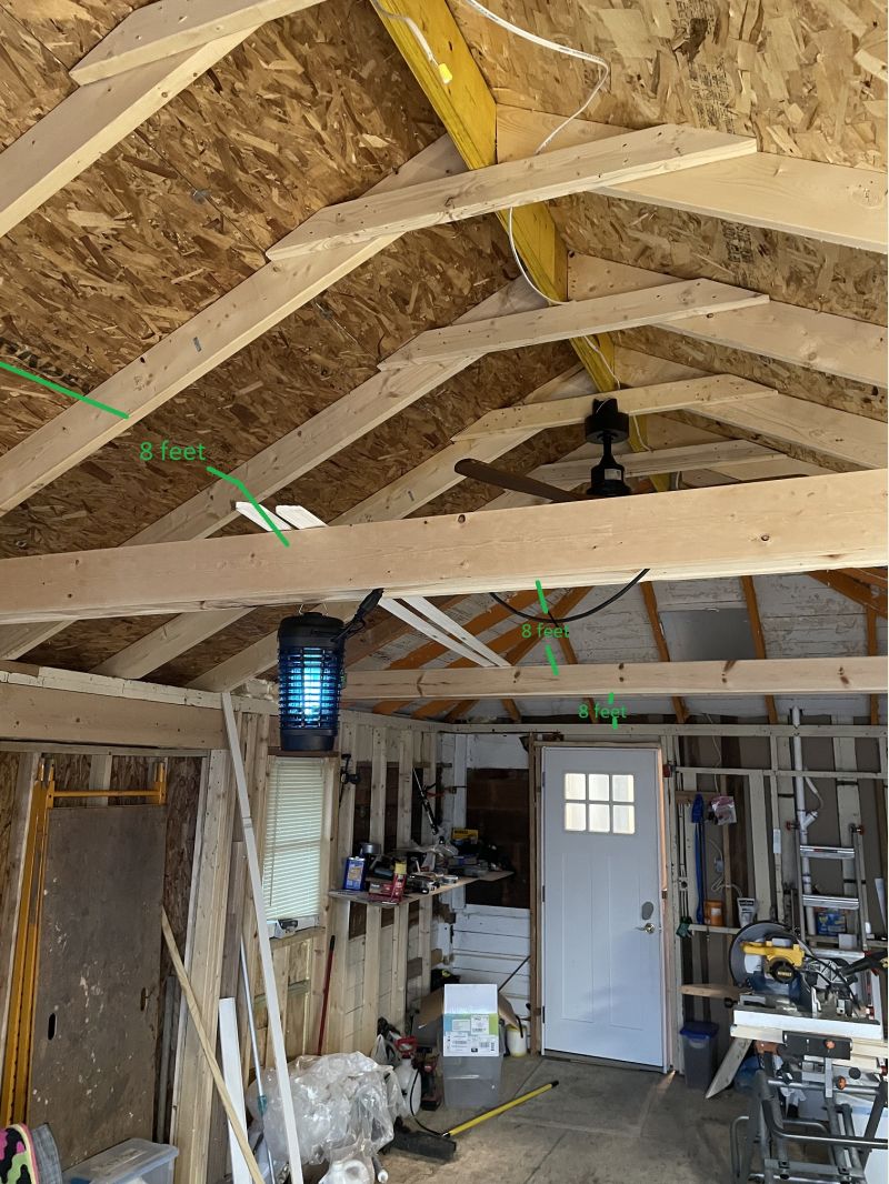

Wouldn't the 2x10's just be a rafter tie and the floor joist of the loft?
I did a 8 foot spacing for my rafter ties, no loft, they were 14' long (small cabin), used a collar tie on every rafter which was 2' on center. Doubled up the rafter ties on the 8' mark on each side of that rafter. Those will become a decorative beam.
We ripped a hip roof off that had a sloped roof attached. But left a portion of the hip on one end.
Rafter
Rafter
