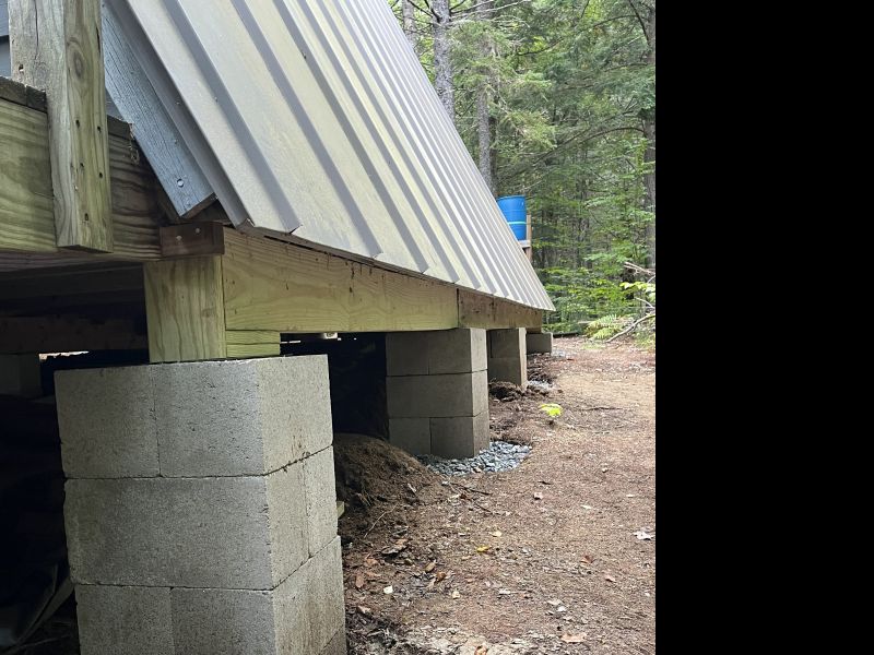

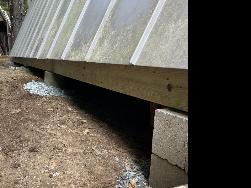

Hello all,
I wanted to thank everyone for their inputs and post some updates. I decided to go with Brettny's suggestion of 8x8x16 concrete blocks filled with cement that sit on a 16x16x6 concrete footing. I also addressed the rot issue by replacing the beams. Thanks again!
Cal89
# Posted: 11 Oct 2024 03:00pm
Oh and the cause of the rot was carpenter ants, not water infiltration. I had some in the cabin too but I was able to get rid of the pretty easily and replaced the wood where needed.

I would build a parallel beam a foot or so behind the bad one as a temp support, jack it in and support entire length.
Then fix corner piers. With the frost so deep, maybe dig down a foot or so, pack in good draining gravel, then pour a nice pad with rebar and build you column off that. Cinder blocks squared, fill holes with rebar and concrete. Remove temp support beam. Dont set wood right on concrete. Flash beam for any water runoff.
DRP
# Posted: 20 Sep 2025 07:42am
Just for info. When we run into carpenter ants we go looking for the leak. They are a sign of water intrusion somewhere, you won't find them in dry wood.
