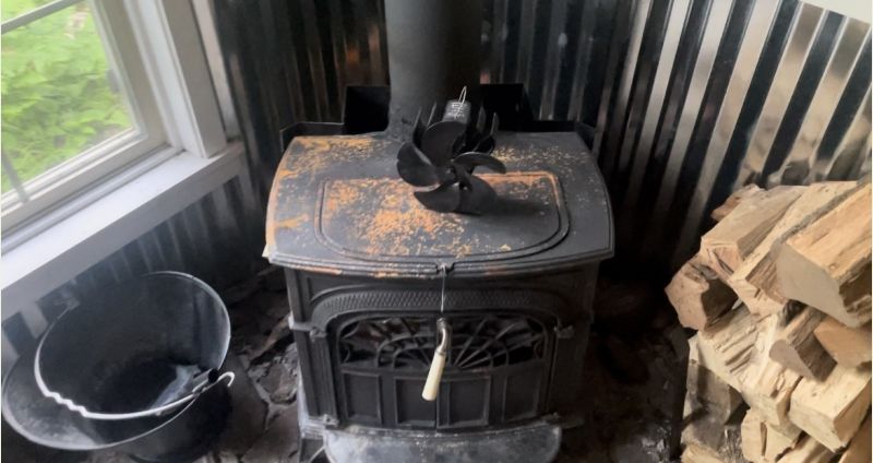

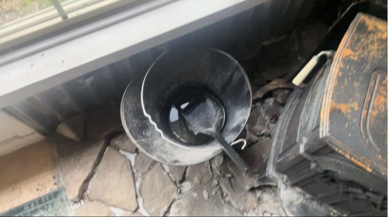

When we arrived I saw this: clearly, I have a leak somewhere around the chimney-and enough that water collected in the ash bucket.
HOWEVER- with this being the wettest spring/summer to date in MN- it did rain every single day we were there- including a 2”+ thunderstorm. Not a drop leaked in during this. It seems like a small leak- so I waited to inspect and wanted to see it in action- but it never leaked. I inspected eventually and nothing looked amiss. I didnt caulk anything yet- want to see it happen again.

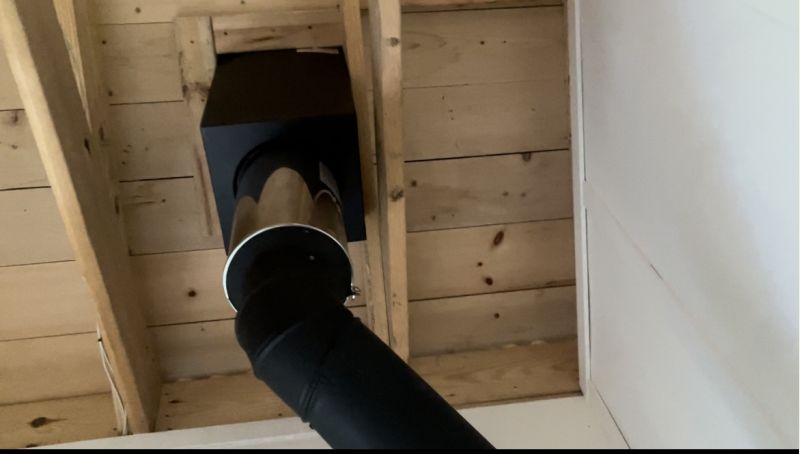

Anyone have ANY idea what’s happening here? I did see some water marks on the roof around the chimney underneath.
There isn’t any additional surface rust on the black pipe-so my guess is it’s dripping down through the support box, over the double wall, and dripping down the double wall. Didn’t see water spots on the double wall though…so idk.
It seems to me that a leak should leak… so if it doesn’t I’m puzzled. Only thing I can think of is that maybe somehow driven rain gets up under the collar?… and even though we sat through one really hard rain it still wasn’t driven hard enough?
It’s a 6/12 steel roof so I doubt there’s any pooling issues… unless it’s somehow pooling on the boot over the chimney.
The boot is not tight on the chimney. The boot is tight on a spacer- which is then covered by a collar- this is the manufacturers design… I have written before about how poor the design is - but the fact is it hasn’t leaked before now.

Now that I think about it- it’s probably not the boot. Therer are water marks on the uphill side of the opening. I did not inspect the snow splitter above the chimney.
Being as the leak would have to be in the steel channel right above the chimney- that rules out anything else I can imagine. Maybe I forgot to silicone a hole or two from where I had to reinstall the splitter last year.
Still doesn’t explain why it’s didn’t leak when we were there though…

I had a mystery leak with the cabin chimney shortly after I built it. Selkirk s/s chimney, ribbed metal roof, silicone boot. It never rained when we were at the cabin, but at times when we arrived there would be evidence that water had dribbled down onto the stove top.
That was finally traced to water leaking in at a exterior joint between the uppermost pipe section and the one below that it coupled to. Rain was entering that joint.Then I believe it ran down, inside the inner and outer skin, where the insulation is. Then it exited at the next lower coupling and ran down the outside of the lower pipe, dripping onto the stove top.
I only figured it put after siliconimg everything else and still having a leak I applied silicone to that joint in desperation. No more leak for 15 years.

But as far as the leak However with water staining on the roof sheathing I think it’s got to be water that is dripping in somewhere else and the running over the underlayment until it hits the hole where the chimney box is. It’s then running over and wetting the roof board as well as dripping probably on the outside of the cathedral support box. The cathedral box is entirely through the ceiling… so it’s got to be the outside of the box.
The chimney never touches the roof so could never wet the boards.

And now that I think of it… it can’t be driven rain around the boot either because that would be inside the box… and that would never touch the boards.
Got to be the snow splitter… but still the question as to why it never showed up again puzzles me.

I had similar at our old shack with a metal roof just once (though not at any roof breach). There was a big rain when we weren't there, came and found some water, so I pulled stuff away and put a bucket under. Nothing ever came in there again.

I also had a leak, a rust stain the size of a half dollar on my stove top. Right after I put the chimney in. I sealed up everything again with Lexal. No more leaks.
You really need to get on the roof and look with a fine tooth comb. Leaks dont happen on the Inside.
