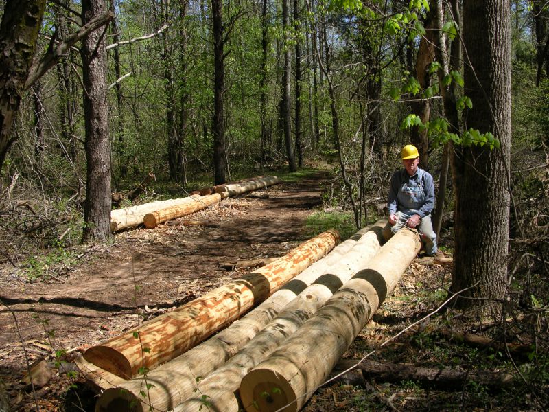

Turkeyhunter: Poplar and Virginia pine, about half and half, the only straight trees of any size on the property. Dried for about a year. I asked a builder of replica cabins at Colonial Williamsburg in Virginia and he said the colonials used anything they had -- except for posts (black locust) and roofs (cedar and such). I'm pushing 70, so I think these will outlast me by a lot. See the exhausted old guy with the drawknife in the photo.

# Posted: 4 Jul 2011 07:09am - Edited by: turkeyhunter
70 heck you are a young cabin builder!!!!!!
i bet those poplar logs would peel easy when they are green.
i got several draw kniives only used them on small logs though. Good luck on your build.............

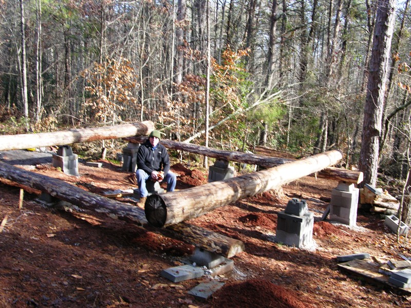

Neb, I'm still thinking on your suggestion about OSB. A problem is I was relying on the 10-foot boards to give structural strength from the ridgepole and purlins to the wall plate. And I worry the OSB wouldn't give me that.
I attach a photo taken last January. I think I was already tired and wondering what I had got myself into.
Are we done yet?
Are we done yet?

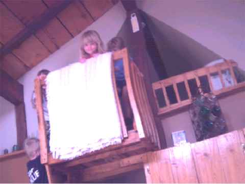

Up in canada we have a product called barn pine, it is 5\4 in. thick. I used it for this roof [pic] . IT is number 3 pine usualy 12 in wide and unplaned i ran one side through my small planer untill i got a bright finish .we can buy it up here for 1$ per sq. ft. . mine were 12x14's i needed 28 . I put a sealer on them before i put them up . had some problems with them , a few knots fellout but they are easy to fix just a little glue. the biggest thing was they dripped tar from some of the boards for 5 or 6 years [only in hot weather ] they had all but stopped dripping when we sold the place after 7 years. good luck
Yep I know what you are saying. You have done a great job and it will be a great cabin when you are done and something to be very proud off. That is a great picture of you. Thanks for explaining the tarheel story and that is very interesting. I have asked that question many times through the years when I see the name and knowone can tell how the name started. Thanks and keep us in pitures and progress on that nice looking cabin.
