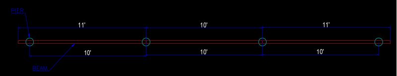

I am building a cabin, 24x32. I have 16 concrete piers already poured. Posts are every 10 feet on the 32' length for the beams, with 12" running out past the outside posts. So I will have a 11' beam, 10' beam and a 11' beam. The beams are then spaced 8 feet apart, thus my floor joists will span 8 foot sections on the 24' length across the beams.
Now for the dilemma, LOL. I was thinking that a 2 ply, 2x10 would suffice for the beams, and 2x8 16"OC for the joists. Some sites I've found suggest that I should use 3ply, 2x10 for my beams. Also considering a 3ply, 2x8 for the beam to reduce the overall height off the ground.

So if I'm following you correctly you are planning on having 3 beams, running the 32' length. Each row has 5 piers or a pier every 8'?

Each row has 4 piers. And minor error in my post. Beams will be 11', 10', and 11', fixed it in my original message. See picture.

# Posted: 6 Aug 2024 02:14pm
So a 1' cantilever out over each end.
Any such overhang on the sides?
Sreid
# Posted: 6 Aug 2024 02:16pm
Yes 1' cantilever with the beams. No overhang the other way.

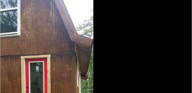

Use tripple 2x12 for the beam and a large head structual screw. I would also recommend 24' 2x10 floor joists if your only doing 3 beams. Your sono tubes are alreaty spread way out.
I have a 20x32 cabin with 5 tubes per beam. Trippled 2x12 beam and 2x10 floor joist. I also subfloor glued the 3/4 sub floor down. It's very strong with no squeaks. Going with a cheaper lumber may only save you $400 but having a floor that's like a trampoline will haunt you for ever.
I would also suggest pulling in all the sono tubes to be under the building envelope. Like the picture shows. Even with no gutters my siding stays prety dry. I also have a decent sized overhang.

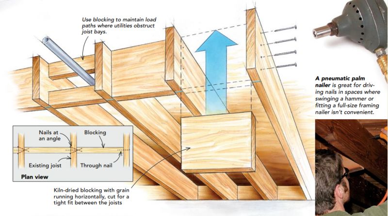

First, there is blocking and there is bridging.
Blocking refers to solid wood, 2" nominal thickness x full depth of joist. Blocking is used at joist ends where there is no band or rim joist.
Bridging refers to "X" shaped straping or 2x2 wood bracing nailed in between joists in a X-shape. Bridging is installed between joists when the run distance from one end (block or rim) to the other end (block or rim) exceeds 8 feet.
Bridging helps stiffen a floor and helps to prevent joist rollover. It is easier to install especially when using metal straps. However, properly installed solid blocking provides greater stiffness and better joist rollover.
The IRC Chapter 5, section R502.7.1, calls for blocking or bridging to be installed at intervals not exceeding 8 feet. Remember the IRC rules are minimum rules, so more frequent bridging can be superior.
Chapter 5 link There is a newer version (2021) but I couldn't find the link on my phone right now and nothing has really changed in that section anyhow.
Overlapping joist ends should be over supports like a beam or a bearing wall. So there should be blocking used wherever one joist ends and another starts.
Blocking should also be placed wherever there is a wall built on top of the floor, perpendicular to the joists.
