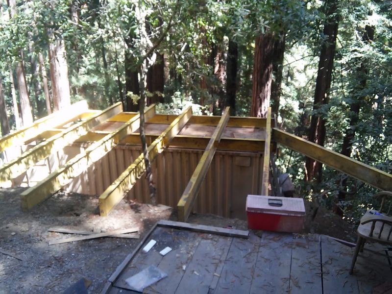

Can’t be much help but I also have a 20’ container that I built my deck on top of some years ago. The sides have a corrugated shape that helps structure, don’t see that in your photo. I did cut a window opening in one side but only about 4x2. Also as you can see I have large I-beams running the length. If you’re going to move it around you might consider, in addition to beams between the windows, removable diagonally bracing.

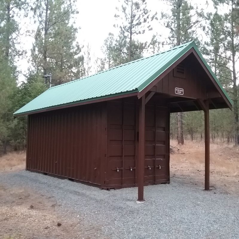

Mine’s in the shade and only junk storage so heat not a problem. It does however have a couple of large holes cut into the top from a previous use. Appears to be just flat sheet metal, easy enough to cut through and no structural integrity. Might be a good option, add a loft!

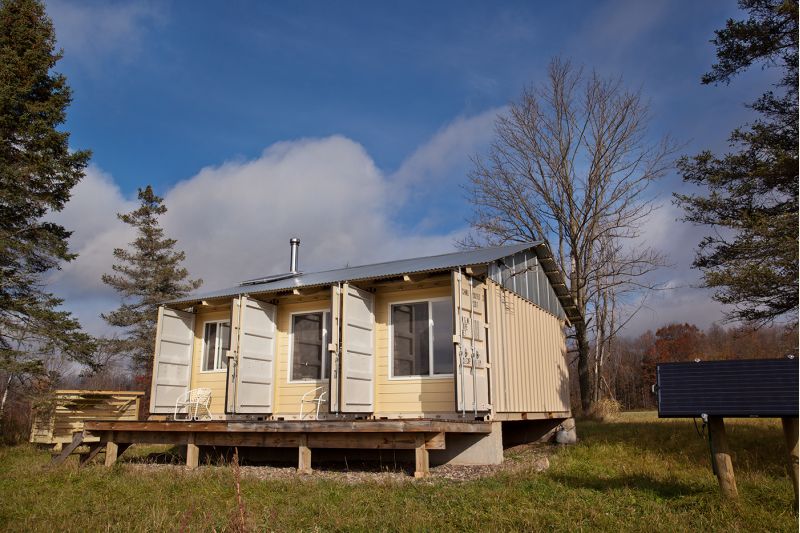

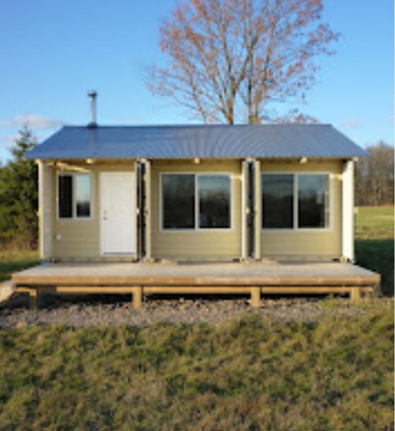

I have a lot of experience with building a shipping container cabin and have included a pic of mine below.
I typically try and discourage others from doing what I did, unless they have a specific need such as myself. I built my cabin with containers for the security they provide - I had a lot of break-ins and theft in my old cabin. Removing a container wall and replacing it with a stud wall totally defeats that purpose.
There is also the cost issue. You absolutely will not save money building with containers. It probably cost me 50% more to build with containers, but for me it was worth it for the security. It will also take you longer to build than a standard frame building, and have huge constraints on your floorplan and any future additions.
One more thing. When I was researching my build I was specifically told not to remove any walls until the containers were welded to my concrete foundation. The issue wasn't one of strength, as I welded steel box beams to those places, but that the container could twist out of square. If that happens, good luck getting it back in square to add your stud wall.
If you really like the look of steel, build a standard frame structure and use steel panels/roofing for the siding.

Now that is what I would call a well executed plan resulting in one of the better vandal snd burglar resistant cabins I have seen. And an honest assessment of practicality, benefits and drawbacks. I like it!

It's beutiful Steve! Where are the entry doors and how did you make them secure? - or is the door on the left side of the picture obscured by the container door?

It looks like you close, latch and lock the container end doors. No?

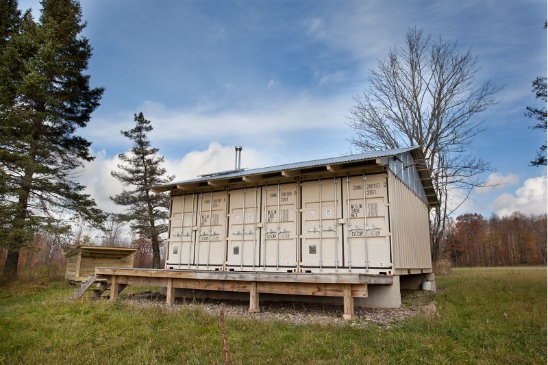

Yes, the entry door is obscured by the container door. All three container doors close and are secured by special container locks. The pic below shows it all closed up.
