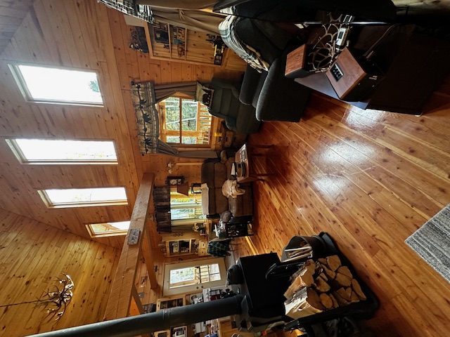

# Posted: 17 Oct 2024 12:14pm
We have red fir t&g flooring but it is maybe 3/4" and it is laid over 3/4" plywood. It does have a few squeaks... apparently wasn't glued. Really like the look.

Quoting: Nobadays
Gorgeous! Where did you get that from? Local source or came with the house? Sadly the original floors were (I think) clear vertical grain Douglas fir. I’ve found similar in 5/4 but it’s costly and not available for local delivery or shipment. I’m not in need of flooring just yet but planning ahead trying to match floor thicknesses
Anyhow, I found a supplier (actually by recommendation of someone here) for my T&G ceiling boards that has 5/4 T&G porch flooring. It’s square edged and looks to install the same as 3/4” T&G flooring. Just curious but how would this be any squeakier than say 3/4 T&G red oak flooring?

# Posted: 22 Oct 2024 03:58am
The floors were in the house when we bought it. The lumber was sourced locally. A small mill in Southern Colorado. But to my knowledge there are no red fir trees in Colorado so they apparently sourced the logs from the PNW.
