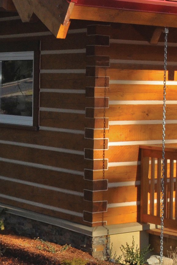

What's happening here....
The tenons of each log have chinking between them. Does that mean there is a spacer between the logs and between tenons in the corners?
If I am not mistaken dovetail logs rest on each other in the corners. (I think).

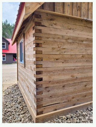

socceronly
# Posted: 22 Oct 2024 01:00pm
Then from the same company, this wall the logs look to be lapped, and not tenons. No chinking at all.
They must put some kind of gasket material in between.
I hope to go see them in the coming weeks, and if I find out anything interesting I'll post it here.
# Posted: 22 Oct 2024 01:54pm
Looks to be similar to our new prebuilt log cabin.
The logs are milled 'square', ours has a tongue/groove at the top joint with a gasket strip between. They sit one atop the other in a nice tight stack.
The outer edges are chamfered providing a nice look and can be chinked but don't need to be. We paid extra for the chinking (it is a synthetic long life product) for the water sealing weatherproofing and look.
The inside has no chamfer, just a seam, so the walls look like flat logs/boards.
We love it!
socceronly
# Posted: 22 Oct 2024 03:01pm
Oooh, I see.
The logs sit on one another but the edges are chamfered. Now I have to go look up the difference between a chamfer and a bevel...lol
Thanks
