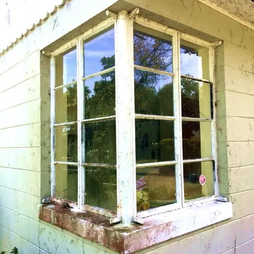

That reminds me of a lot of the older homes here in NM. They used single-pane metal frame windows with a grid of panes in many homes back in the 40s and into the 60s. They can frost up nicely/badly in cold winter weather.
This is a typical old corner window found in many kitchens here. All steel, single pane. Usually casement style. This is in a concrete block wall but they were used in stick frame construction too.
If carefully removed we could eventually find someone who would pay nutty $ for refurbishing and re-use.

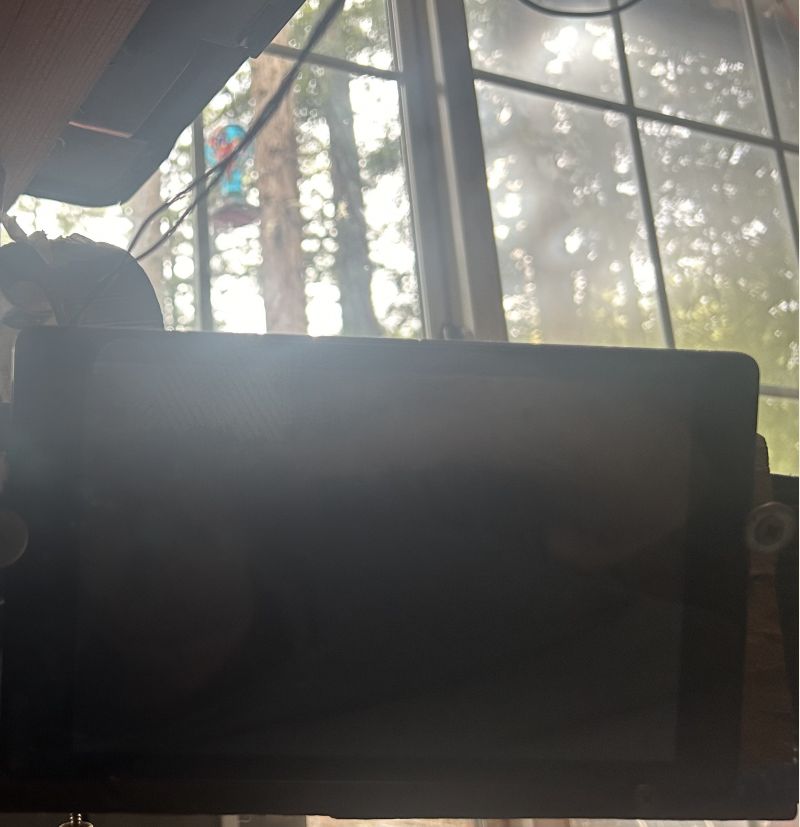

One of my cabin windows is hazy between the glass, always been that way, summer or winter. Not that big a deal, worth taking apart. Anything to do or just live with it? It is the presumably removable sliding side. Right side of photo.

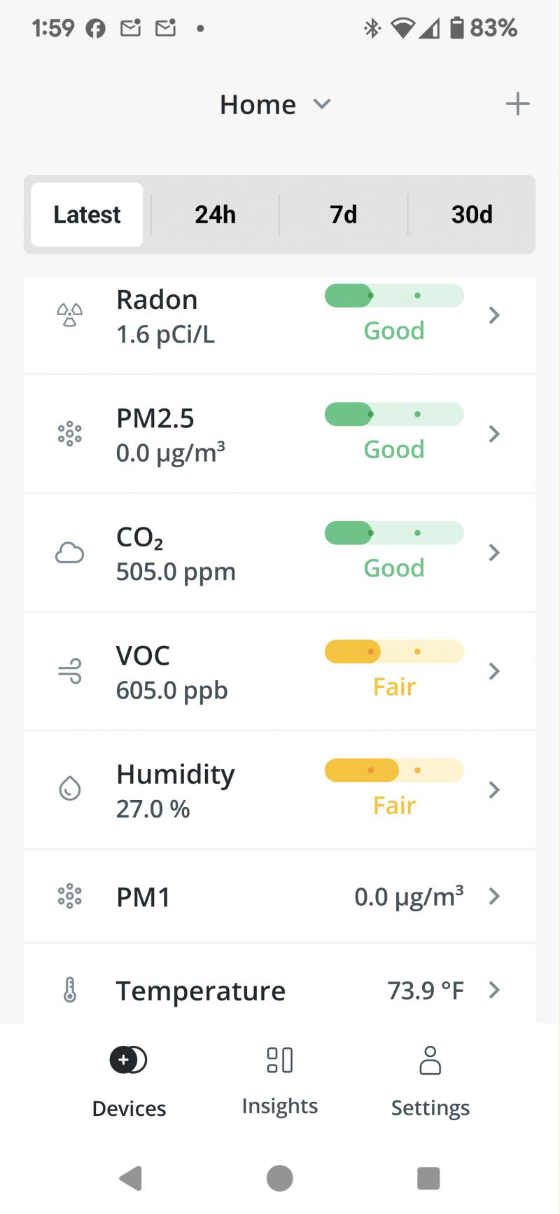

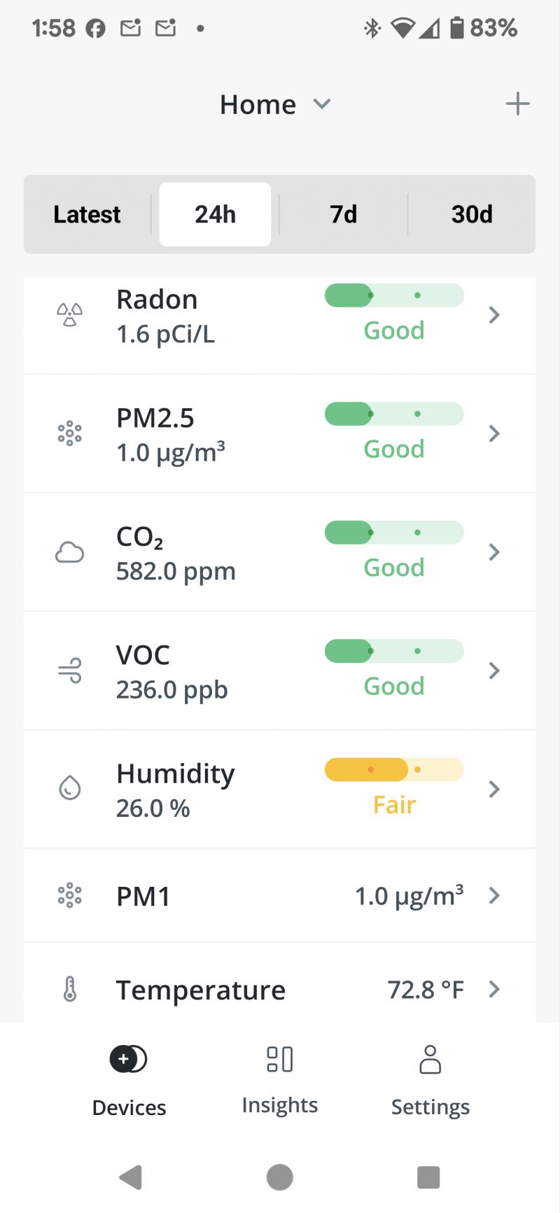

As was mentioned by travelers, Heat Recovery Ventilation is required, or at least is the best way to go. You can then build as tight as you can and keep the interior air healthy without losing the interior air temperature. It works summer and winter.
My brother's company built many very energy-efficient homes with HRVs included. The equipment costs will be paid with the energy savings. Looking at square footage and comparing the new builds to older homes, the small amount of energy needed to operate the ventilation fans in an HRV is negligible compared to the amount of energy that good air-sealing and insulation saves.
I'm pretty well sealed up and equipped with an HRV. I have trouble keeping the humidity up to above 30% as you can see in the photos.
The high VOC's level in the current conditions image is because I just painted a wall. That should be helping to raise the humidity but I have a window open to air out the odor a bit and the exterior humidity is only 10%. The 24-hour image shows the average over the past 24 hours.
