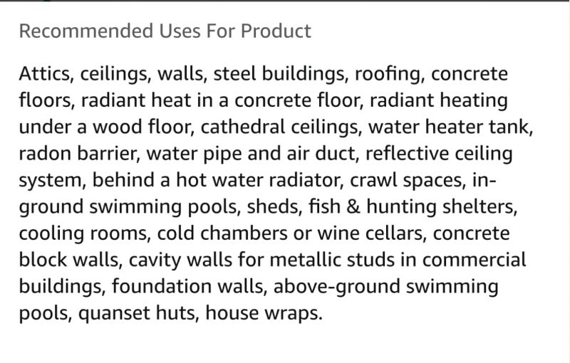

# Posted: 24 Dec 2024 02:02pm
I’m sure you’re right but it did say it does everything but cook dinner. If nothing else it will smooth out any seems in the plywood (which has air gaps I’m sure) and make the floor a touch softer.

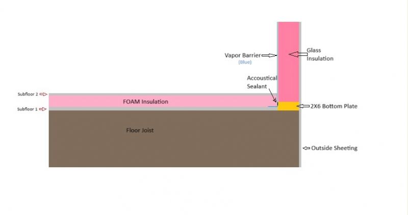

# Posted: 26 Jan 2025 10:44pm - Edited by: travellerw
I raised all my stuff and did foam, then 3/4" OSB, then finished floor. I used accoustical sealant to secure the vapor barrier to the bottom plate, and made the vapor barrier long enough to tuck under the foam by 4". I think we used 2" foam.
After the cabin gets heat soaked we can walk around in our socks even when its -30C.
If you haven't built yet and have the opportunity to plan and do it like I did, its totally worth it. Super warm, well sealed and best of all no rodent issues.. and no working under the cabin.
Since our cabin is fairly small (16X28 with a 2/3 loft) we took extra care on the insulation. It has really paid off as we have stayed at -40C (-40F) multiple times and it takes barely any wood to keep the temperature once everything is heat soaked.
travellerw
# Posted: 26 Jan 2025 11:15pm
I thought I would post and image to show what a cross section of our floor looks like.
The only real downside is when you install baseboard there is no bottom plate to nail too (as the floor is now above it). You need to nail the baseboard to the studs top and bottom.

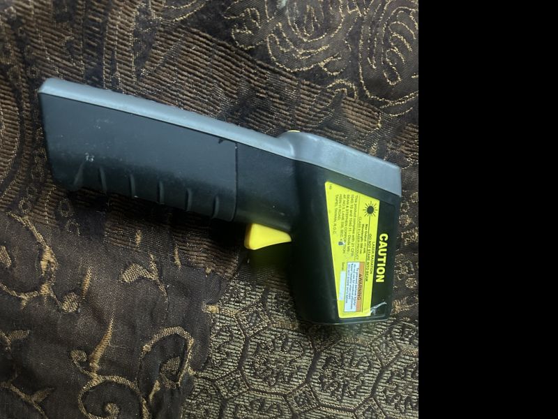

# Posted: 28 Jan 2025 12:53pm
Finally remembered to check temps when I got here yesterday using my handy point and shoot gun. Floor was 41, wall 42. Humph. This morning, after a night of wood stove, floor 54, wall 62. Cabin 66.
I haven’t done any floor insulation. Since it’s pretty even cold, not sure I’ll bother. Once the place heats up, cold floor feels ok.

# Posted: 28 Jan 2025 05:25pm
Quoting: travellerw
Great point.
I could just put some blocking in for that at the right height.
Thanks
