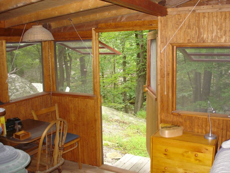

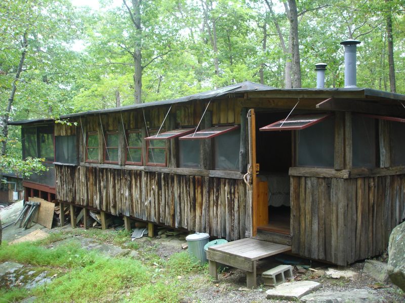

Most of the cabins in our community have top hinged wood framed windows, with a cord passing through a pulley on the eave and through a hole in the wall above the window to pull it open. When I redid ours and added an addition, I got a bunch of free-on-craigslist used windows and built window frames to match.
