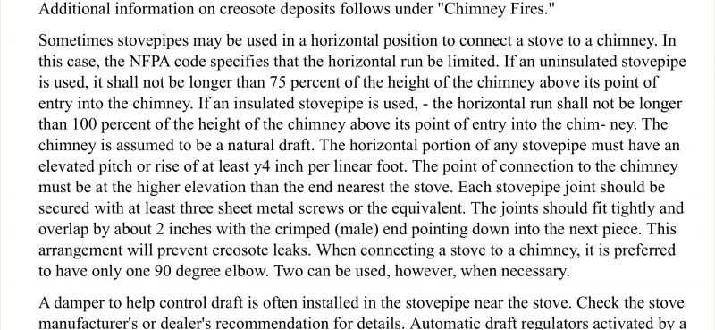

# Posted: 3 Jan 2025 06:42pm
https://www.extension.purdue.edu/extmedia/fnr/FNR-100.html

# Posted: 3 Jan 2025 11:53pm
# Posted: 9 Jan 2025 08:01am - Edited by: paulz
