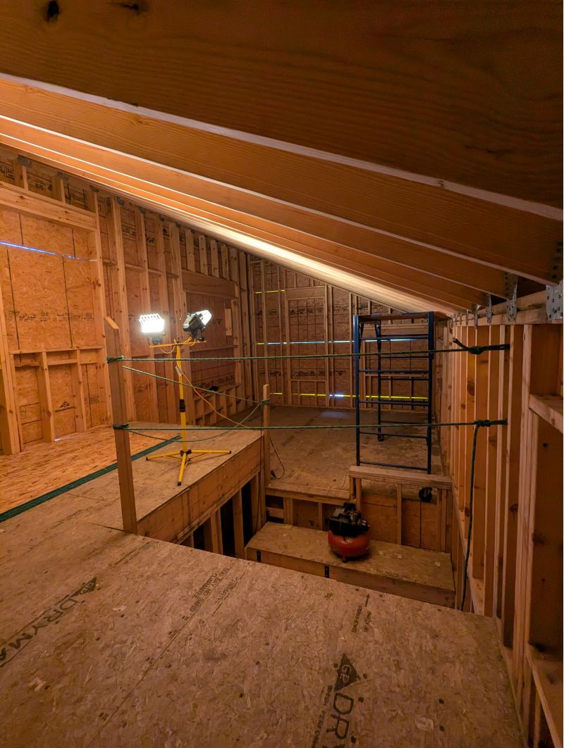

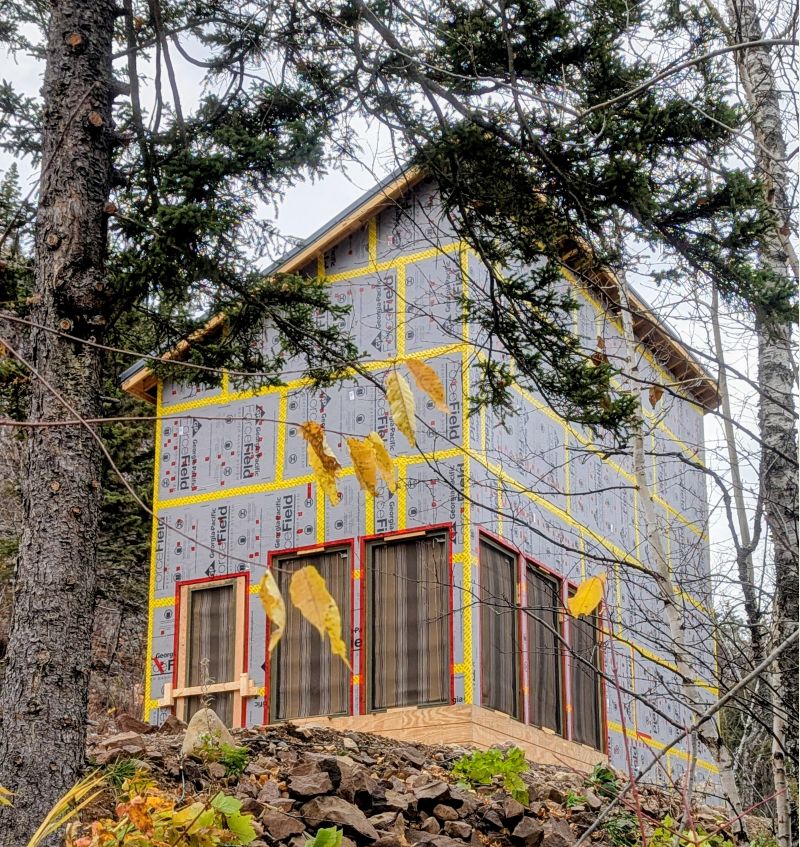

# Posted: 8 Nov 2025 12:12pm
[img=null]null[/img]
Exterior of Cabin Dried In for Winter!
Exterior of Cabin nearly dried in for winter...
Upstairs w/ 2x12 rafters
