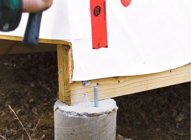

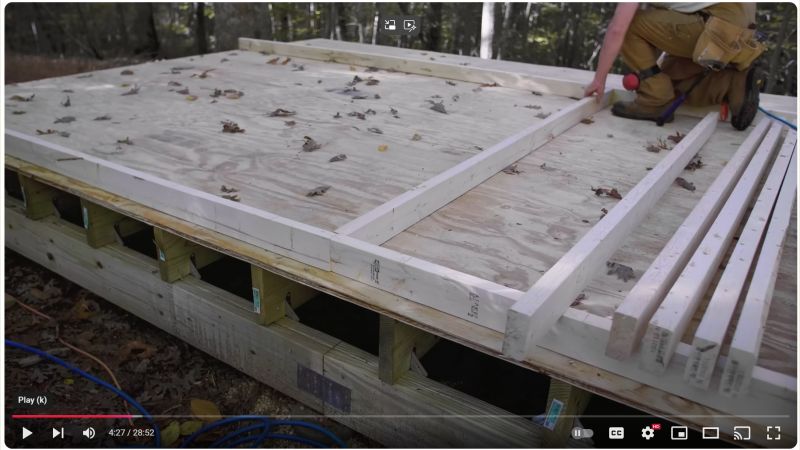

https://youtu.be/61-X2-c4UR0?si=9RDax95xGcNpuSVM&t=269
I mean... they use a double ply 2x for the beam... so it seems sensible to rest a rim joist on the outer one and set the joists on the inner one.
At this point it looks like something might have been done but it is hard to tell.
https://youtu.be/61-X2-c4UR0?si=huFCX35oOK1e3seR&t=774
Here it looks like they just extended the OSB down to cover the joist ends.
https://youtu.be/61-X2-c4UR0?si=kw4YYwaE7dPgwSlW&t=798
# Posted: 30 Jan 2025 10:10am
That does have rim joists. What your mostly looking at is the girders that are flush with the rim joist.
Looks like hes extended the siding way down to cover as much of the girder and rim joist. That's how siding should be.
socceronly
# Posted: 30 Jan 2025 10:31am - Edited by: socceronly
I'm just learning so... maybe I am using the wrong terminology.
Shouldn't the joist ends be connected to a 2x? Isn't that the rim joist?
If they add it later, why? Wouldn't it stick out from the other framing?
It also looks to me, like in the last link in the post above that the OSB covers the joist ends and nothing was added.
It looks like the OSB comes straight down in which case I can't see how anything was added to the outside of the joists.
Not trying to be a jerk or anything. Just trying to learn this stuff and this seems to go against everything I have seen. That's why I was asking if they did something else.

I don't think he did. (on the long side) I would have. To create a complete rectangle for blue board and foam to insulate the floor.
