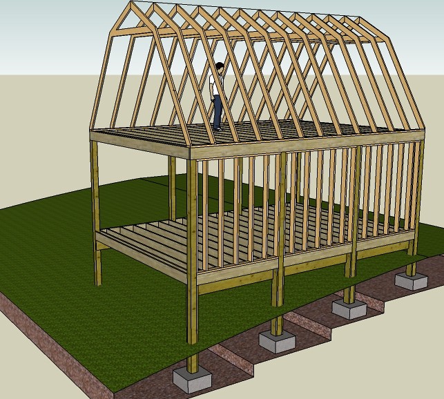

My takeaway from all that is to find a good company and consider sitting down with the engineer and making sure you get a price on a good performing setup. Most of the salespeople, as a product matures in the market and those stories go around from the first gen or the cheap knockoffs... the salespeople ask, "So you'll be wanting the improved L720 package". "Oh yeah, 720, 721, whatever it takes". When its all done and said and I've read the complaints, I've thought, welders are cheap and rebar or pipe X's between posts would brace it. You. or a local welder can fabricate gussets to brace it, all IF it is shaky. Steel has a lot going for it
Another option might be more of a post frame type with a raised floor. Simpson does have high capacity hangers that could carry floor beams on a post. In this old sketch I had, ignore/change the roof style, the wall sheathing is the bracing for the full length posts that are cantilevered from that rigid, fully sheathed box. As opposed to the typical pier and beam that is a rather loose vertical pile of poorly braced parts. Building in this style runs the loaded posts unbroken full height and braced for 2/3 of that height.

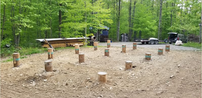

# Posted: 23 Feb 2025 07:32am
For our 20x32' We chose to do 12in sono tubes right up to the bottom of our tripple 2x12 girders. We started lunch time on Thursday, dug and had the forms inspected mid day friday. By mid day sunday we where done and headed home. We used an electric cement mixer and bagged concrete. Total cost was about $700.
