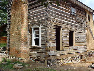

It was pretty common here for the main floor to be independent inside of the log crib. It could be levelled and worked on independent of the logs is the only explanation I can think of. I have put in at least the 3rd floor system on one.
The 1st pic is one like that, it is easier to support with the floor out but I remember having trouble holding square without it there. I put in a stone foundation with a shelf inside to support the floor system. The lower 2 courses here are replacements from a salvage cabin about 50 miles away.
The thought of taking it down and rebuilding it made me wonder how far that same money would go towards buying new replacement timbers and reconstruct rather than rebuild the cabin. I've taken down a few and with the condition of what was there, most were not rebuildable. Survey it with a critical eye.

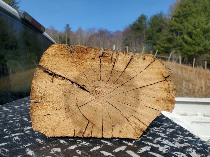

Vaguely on topic from earlier today, I was offered a local cabin that is coming down. They think it is chestnut. It's always chestnut . The third pic... it's tulip poplar, with a bit of powderpost beetle damage in the sapwood. Notice they only go for the starchy sapwood.
