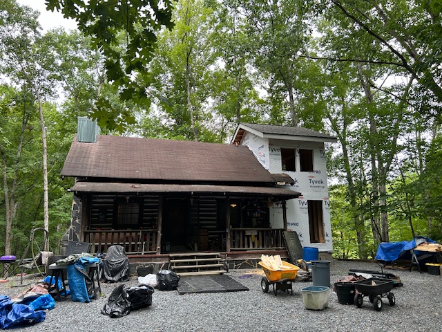

Appreciate any input on window suggestions for a small cabin addition, trying to watch budget but want quality which may be tough, amongst windows so many grades and price points, trying to keep simple been looking at Lowe’s, Home Depot just because generally cheaper than contractor supply houses if buying as homeowner. Rather have a vinyl with probably Brickmould frame so don’t have to trim out as well and probably don’t want a j channel, so I can butt Hardie siding directly against window. HD has American craftsman on lower stock while Lowe’s has Reliabilt their brand and United windows. Of course they can get other windows with special Order. Anyone have any advice please as good mix, quality and good value
