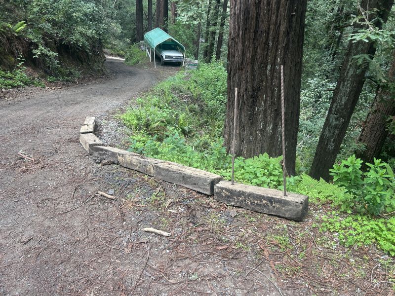

Just this week I put these old railroad ties at a dangerous turn in my driveway. Drilled holes through each for rebar stakes. It was a bear, first inch was creosote, murder to drill through.
