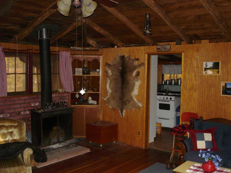

When we redid our walls with ply-bead (beaded plywood) I wanted to sort of match the color the existing chestnut roof and and exposed log rafters; I used a translucent exterior oil based stain (Cabot "heartwood"). It stunk for a week or so, but I really like the way it came out. Later when I did the last bedroom, the oil based product was no longer available so I used the new water based version, it's not quite as nice but very close (no pic of that room though).

Looks great Fanman!

I don't know the number, but it's Cabot Heartwood translucent exterior stain. It comes in both water and oil based versions. I thought the oil version was discontinued when all I could find was the water based, but I've since seen the oil version in stores. It may depend on what state it's sold in.

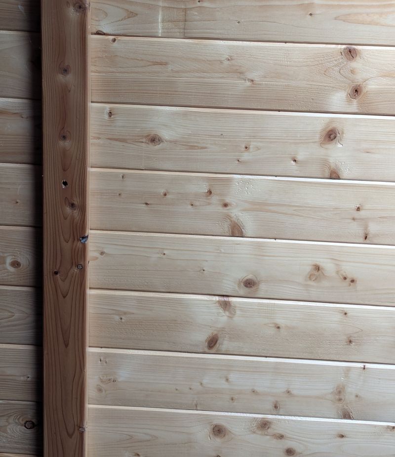

Sampled the water based polyurethane today and couldn't tell it did anything at all to the wood. Was hoping it would at least make it look wet to give it somewhat of a finished look. Will be returning it back to the store. Definitely going to look into an oil next, like linseed oil as DRP and gcrank1 mentioned...or danish or tung oil.
I prefer something that is going to brighten the wood, not necessarily change the color much...now it's dull and bland. I may still consider oil based polyurethane as I have a big garage to let the siding air before bringing it inside but definitely looking into oils next. Based on my research, tung oil looks to be the best choice for toxic odor concerns. Anyone here used tung oil???

You can build a sheen or gloss with water based poly. 1st coat will soak in and raise the grain. knock that down with 320 grit sandpaper and apply a couple more, then sand lightly, wipe with a tack cloth and apply the top coat.
