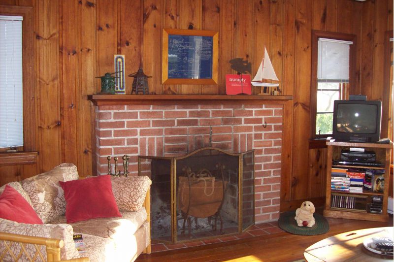

  our cabin at the lake has red pine t & g 1 by 5 an 6 in. radom been there since 1949 no heet ever . not one cuped or bad spot in the whole place . been refinished once buy me and verathan

  Just, I love that dark aged wood look. Looks real nice!
# Posted: 17 Jul 2011 11:04pm
  only time and love makes things look that way, money won't do it !!
