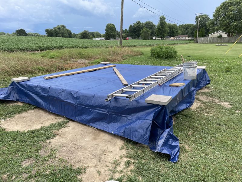

Ime Double Tarp!
I also recommend Not laying the tarp(s) flat on the deck! It will puddle and may seep.
Maybe make a ridge with sawhorses in the center and stretch the sides down to the rim joists. You can weight at the grommets with gallon water jugs or tie off to a beam, etc.

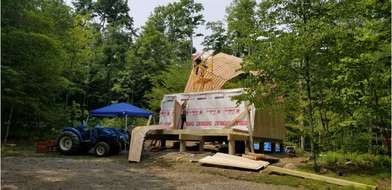

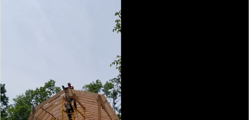

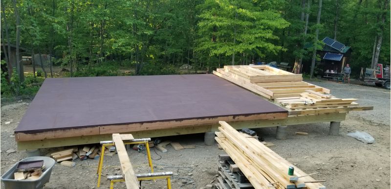

For our 20x24 subfloor that I left for 2 weeks with no roof I used behr deck over paint that i found for super cheap on face book. We have all the walls built in sections on the right so that in 1 day we could stand up the walls and start putting the roof on. We had a prety tall and heavy roof though. Subfloor to tarp over the rafters in 3 days.

Thanks for the ideas. I had already planned to paint the sub floor and I do have a 16x20 heavy duty tarp. Yesterday it rained and I had the tarp over the joists and it worked great. I will be painting the OSB sheets in the garage before I take them out to install.
