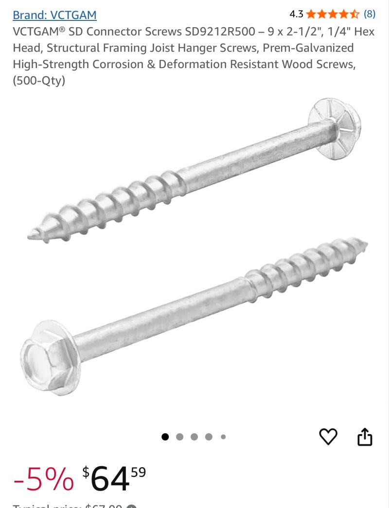

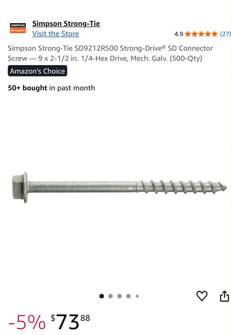

Gone through a few small boxes of these locally, expensive. Time to get a big box. Amazon has another maker for a bit less. Same thing?
travellerw
# Posted: 31 Jul 2025 11:13pm
My vote is no.. not the same.. While they look the same, the main difference between "structural" and regular fasteners is the heat treating. Structural fasteners remain ductile and are able to bend much more before snapping.
Unless the off brand has some kind of certification, I would doubt the heat treating is the same as the Simpson brand.
Further.. A deep google search of VTCGAM seems to bring up Vision Turning Component company of India. While they make fasteners they say nothing about structural.
In short... I don't think its worth the $10 risk!

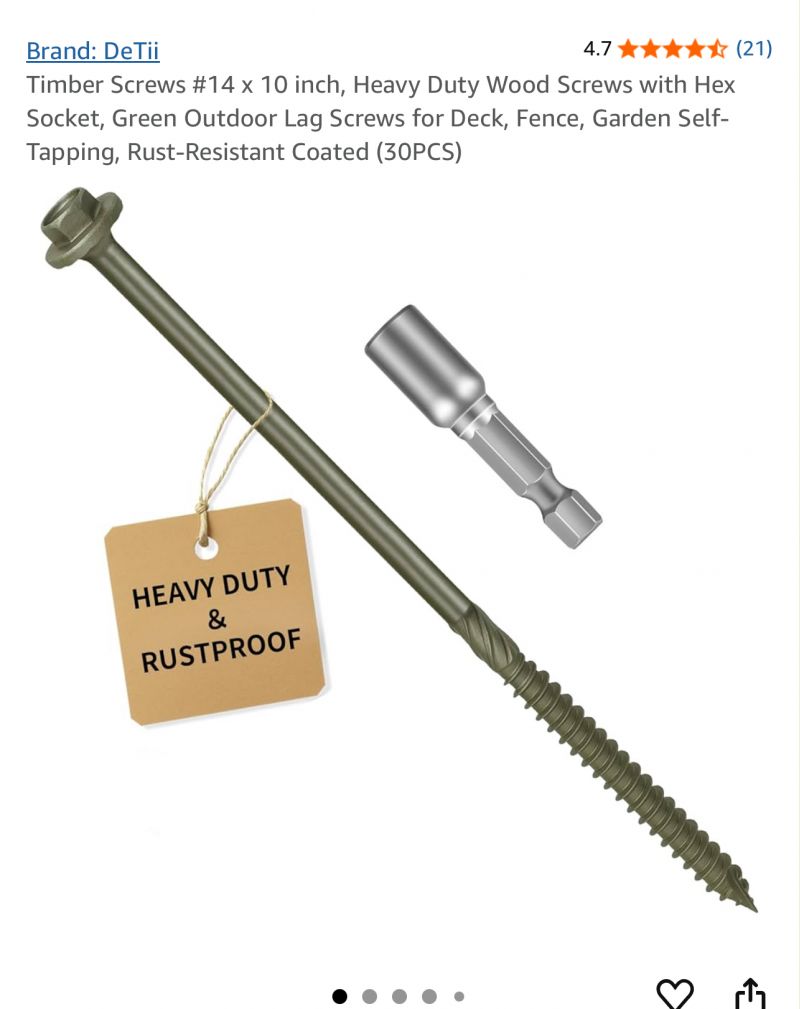

Thanks guys. I’m not putting up beams or anything, just use them for simple projects that may come back apart later, super handy for that.
Also might get these 10 inchers, good for going through a thick redwood branch.

I ordered the VTCGams, still have a few of the Simpsons to compare. Also getting the 10” pack. Test results next week. I looked at the regular lags, not much price dif.

# Posted: 3 Aug 2025 11:07pm
I bet they're the same. Provided they're being honest, the VTGAM description states they're structural, premium- galvanized, high-strength.

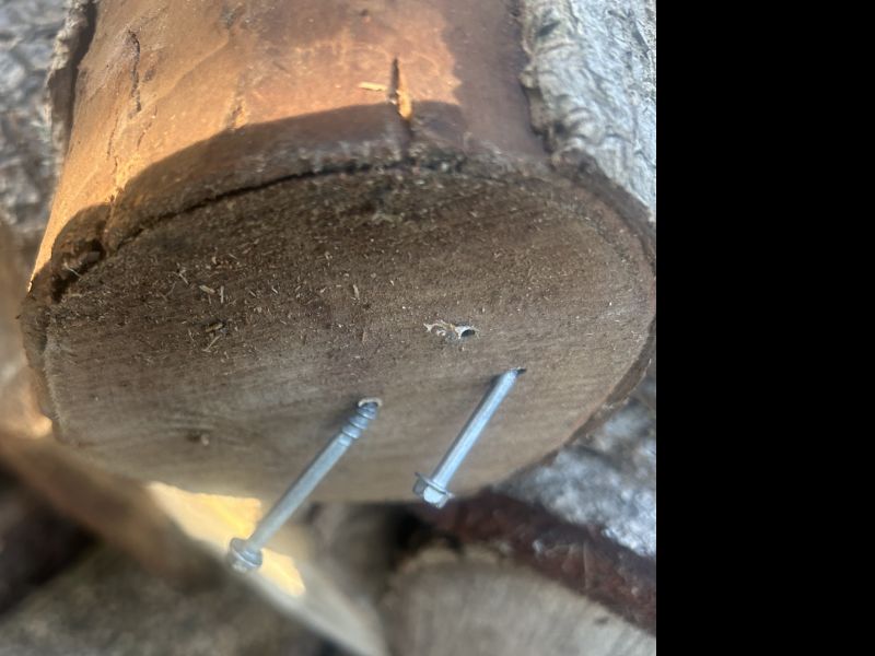

# Posted: 4 Aug 2025 08:32am
Arriving today. Test board at the ready.

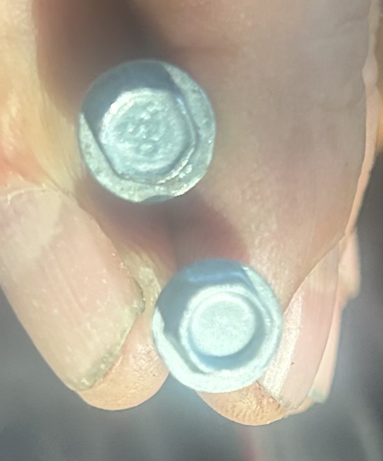

# Posted: 5 Aug 2025 11:02am
Tested the new VCTG screws. Screwed in no sweat. Hammer whack bending broke the one at the threads, other no problem. About like the Simpsons, which have a marking cast into the top. These are blank.

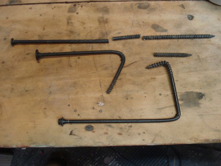

# Posted: 5 Aug 2025 10:11pm - Edited by: DRP
My Simpson fasteners are at work but I wandered down to the shop and broke some, uhh, stuff.
The top fastener was a no name gutter screw, it broke at the threads, or anywhere else with not much pressure, I bent all these by hand in a vise.
The second was a SIPs panel screw. It broke at the threads but was ductile in the shank, where the "work" is supposed to happen.
The 3rd is, I believe, an Oly screw, olympic fasteners, a leftover log home screw, with an ESR. The real deal, I've used many thousands of these, we used to travel with 2 thousand under the seat for spares and the suppliers would send several thousand with the house.. Here's the ESR;
https://cdn-v2.icc-es.org/wp-content/uploads/report-directory/ESR-1078.pdf
Before these were common we built log homes with 3/8 lag screws. At A36, 36.000 psi tensile. We would snap lots of these. The hardened fasteners were smaller diameter and triple the tensile strength, we would strip those out in the wood long before they would part...; one of those diameter, depth of penetration, specific gravity, tensile strength equations. It can be a deep subject. We would carry 3/8 lags for more pull down but also aware that they would snap easier.
Basically a building is members that are held apart by critical connections. We size the beams but tend to ignore the connections, yet, the connections are the most common failure point. If nothing else, remember that! We want strong ductile failure, a building should distort visibly and howl before failure. If there is a brittle failure... snap whump, you Eff'ed up bigtime. Do not assume, when it matters, look for that ESR that says it is good steel and the real deal.
My wife was trying to get 2 logs screwed together "dollar bill tight" on one job. That company had sent lefties and righties, logs with both left hand twist and right hand twist, we never built for those dummies again. I was cutting with the 16" skil saw, a fair amount of noise, and heard what sounded like an automatic weapon. She had five 3/8 lags in tight spacing trying to pull the logs together, working them a little each at a time. One broke and it zippered, 5 lags broke in rapid succession, brrp!

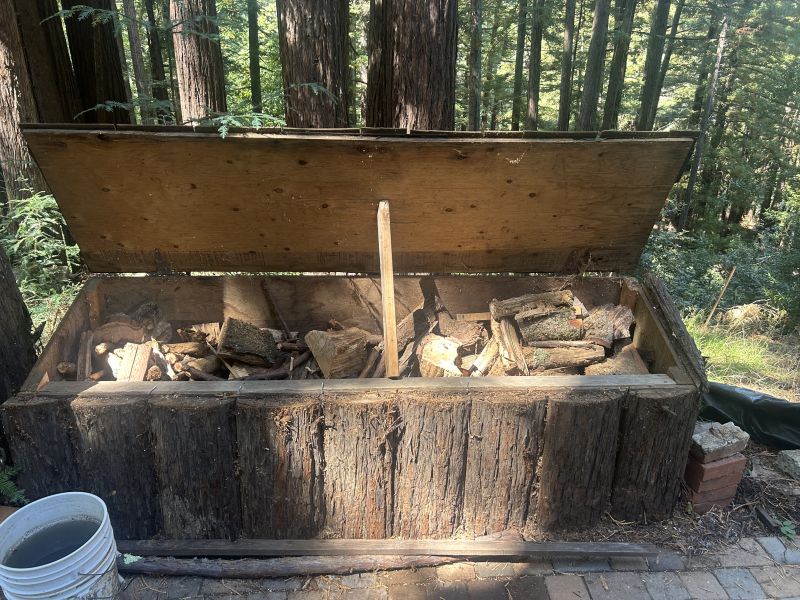

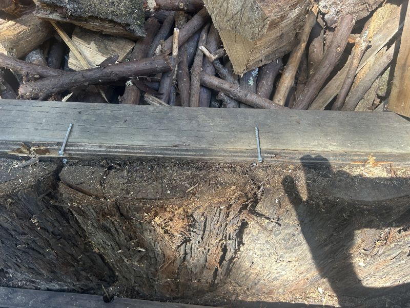

The plywood front wall of my firewood box had warped out badly due to overstuffing it over the years, to the point of a 3” rain gap in the middle. So yesterday i screwed a 2x4 across using the new VCTG screws. No muss no fuss. Ive used them in several other minor things, super handy compared to screwdriver heads. Theyll take the torque of burying the head in the work until the hex drive slips without breaking if you dare.

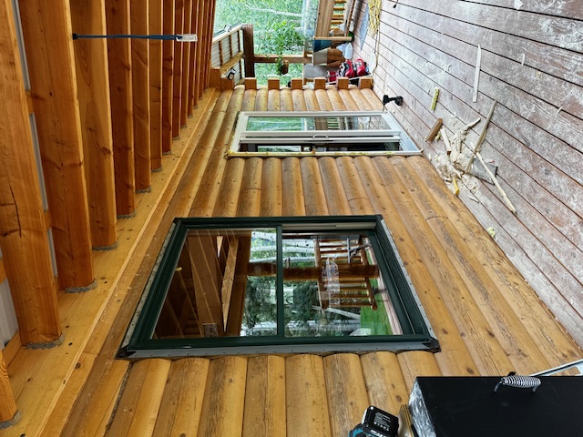

We put in a sliding glass door where a large window was and moved the window over about 5 feet. We knew we would be cutting through several Timberlok screws in the process, and we did... if memory serves 9 altogether.
I had searched forums ( may have asked here) what would cut those screws. Ended up buying a 2 pack of Diablo Framing/Demolition circular saw blades. The first screw we hit we all looked at each other because we all heard it hit but it went right through like butter! By the last couple that were cut it was evident the others had taken a toll on the sharpness but it was still no effort to cut through them, just louder... still life in the blade. To say the least I was impressed with that blade!
