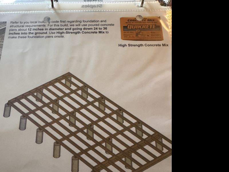

I’m building a 12’ x 20’ (with attached deck) SaltBox cabin. Looking at the plans that I bought online and scrolling through the reviews for the plans I realize that the floor joist are going the length of the cabin, but I want the skids to go the length of the cabin (24’) and the joist to go perpendicular to the skids. So I’ve sketched out a new floor plan with the corrected placement of the joist (that includes the deck). My question is how many (12”) concrete piers will I need? The original plans has 20 concrete piers which seems like overkill.

Those 'plans' may not be real engineered drawings.
How about showing us what the plans are for the deck for some analysis?
Fwiw, we have a prebuilt log cabin, 12x28, with the real skids the long way (they are skids because it is a prebuilt). The 18 concrete silo staves, 9 per side, make a floating foundation under the skids, all on about 18" of Compacted crushed limestone.
The joists span the 12' span with no center support.
You have to size skids/beams, joists, etc for the load and span. The joists must be at least the min for the span or you will have a bouncy floor
If those drawings are not properly done the sizing may be wrong.
And remember, you start the build from the bottom, that is No place to compromise. This means even the sizing and depth of the piers for the soil type you have.

You could prob run 4 sono tubes along a 24' girder. I would use a tripple beam for this. For instance 2x10. I would do 8',16' and 8' pattern on the girder. Then every break/joint in the girder would be over a sono tube. You could also source 24' lumber.
Also pull the sono tube in from the edge of the building 10in if useing 2x10s. I also also use PT lumber for this.
