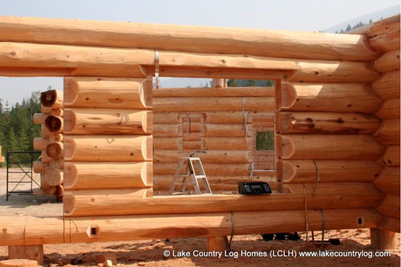

# Posted: 13 Aug 2025 06:06pm
Can you do this...

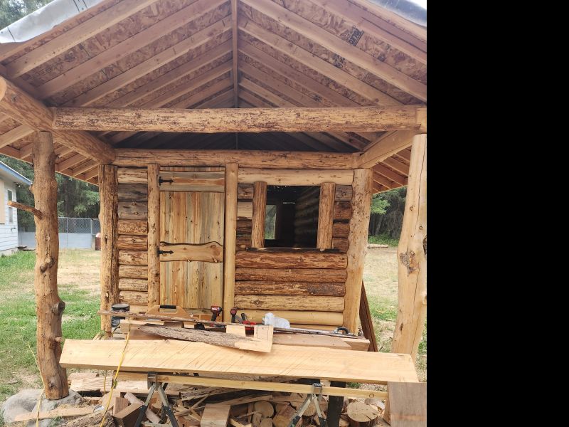

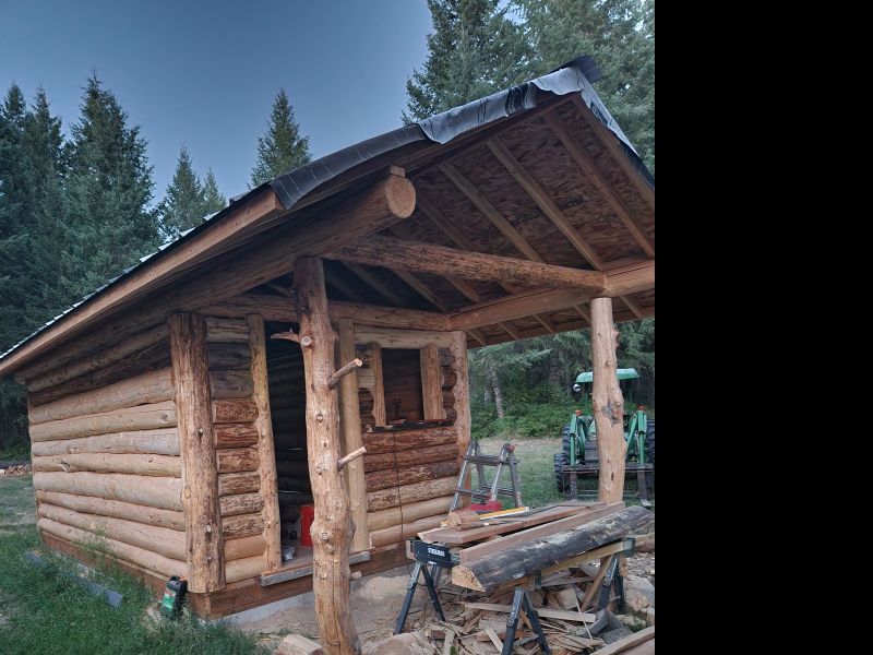

Here's a front view of the sauna...
Hoodoo creek
# Posted: 14 Aug 2025 01:28am

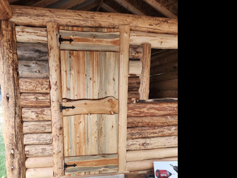

Better view here... the door needs to sit inside the flat plane of the vertical log, but swing outward, and clear the radius of the log without breaking or bending the hinges

Can you add something like a 2-by to the hinge-side of the vertical log and attach the hinges to that so the door has some more clearance from the vertical log on the outswing? Maybe even add another 2-by to the opposite vertical log for a symmetrical appearance? Sort of like re-frame the door? Or, if you move the pivot-point of the hinges to the very front edge of the flat plane, won't that give you enough clearance on the outswing?
Hoodoo creek
# Posted: 15 Aug 2025 11:39pm
That's sort of what I did. I moved the door out as far as I could and I've already got a wood box i built, that will sit on the deck to the left of the door and act as a door stop.

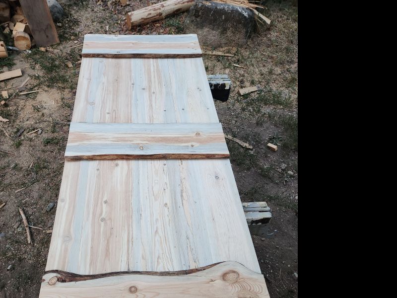

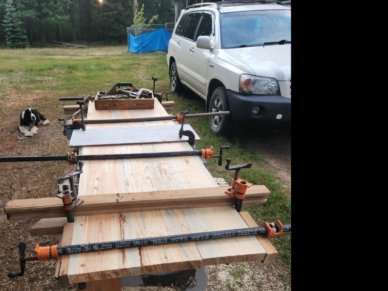

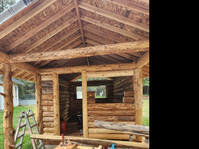

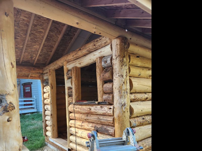

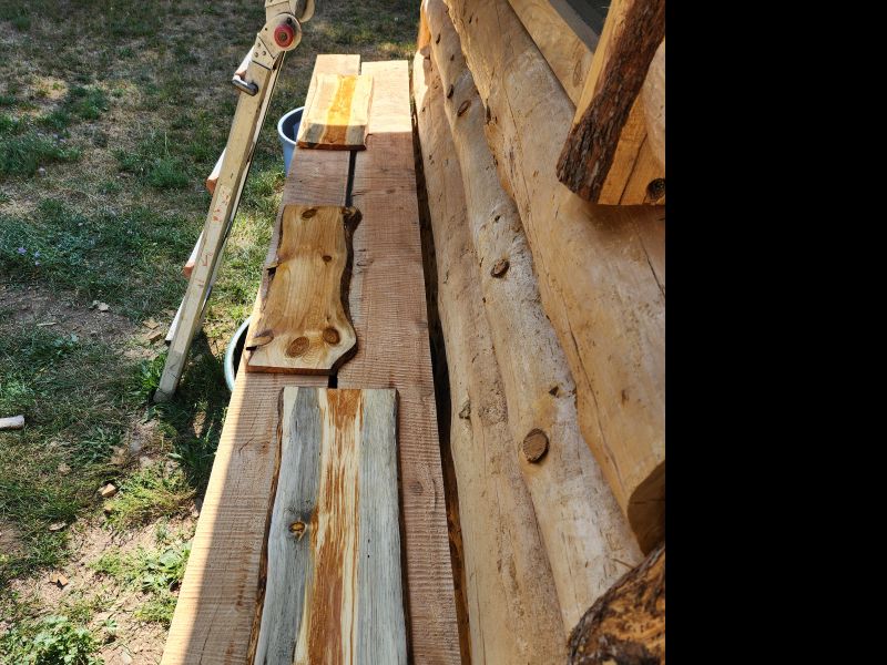

Hoodoo creek
# Posted: 15 Aug 2025 11:40pm - Edited by: Hoodoo creek
A few more photos....

# Posted: 17 Aug 2025 10:41am
I see notches cut in the vertical log to accept the hinge plates. What about extend that notch the full height of the log?

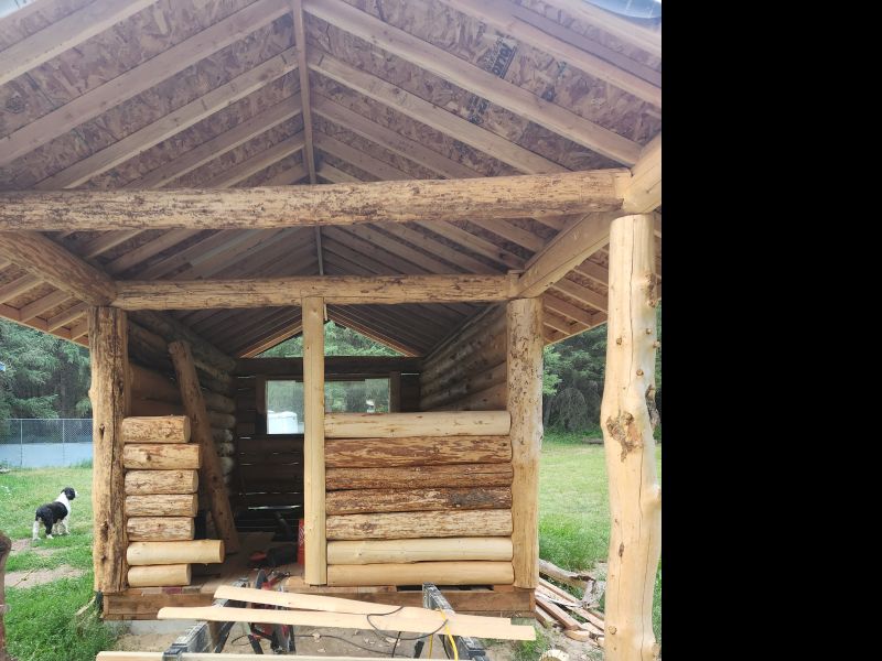

# Posted: 18 Aug 2025 03:19pm
Certainly! I started cutting logs in May, but most those progress photos with my old phone
Hoodoo creek
# Posted: 18 Aug 2025 03:20pm
I'll include more photos soon!
