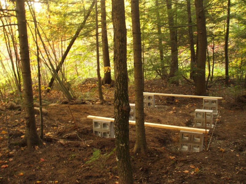

Just wanted to share with you that we are getting a 12x8 bunkie built by a known Ontario shed company soon. We set our foundation using six patio stones set on 4-6" deep gravel, and two concrete blocks high stacked on each patio stone. It took us a while to do as we are pretty slow at anything to do with construction. I hope that this will survive the winter frost and that the building won't shift.

I hope it is not too late... looking at your picture, you have your foundation blocks laid wrong. A cinder block has VERY little strength when laid on its side. You may also want to fill them with concrete.
Good Luck

Well, if it's not too late, talk around your foundation situation.
Something solid (such as Danno suggests) will do the job, and much less weeping and gnashing of teeth afterward. Not sure what those boards are for, but surely not for sill plates, right?

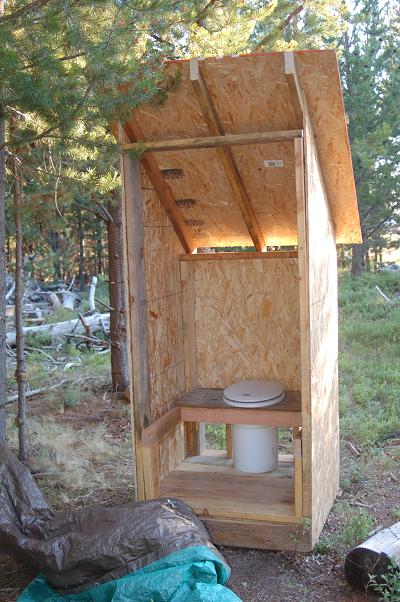

Plans for a privy? Serious?
Check out the pic of the one I just built this weekend.
Notice the 5 gal pail, of which I will have a hatch door for removal, and just enough room on the top for a bit of plywood to cover the pail when not in use)
Happy Trails
Gary O'
privy

I know this is an old post, but I think it's worth commenting/asking if anyone comes across it.
Shouldn't those blocks be stacked the other way in the foundation picture above?
I thought if they were stacked with the holes to the side, they will break.
# Posted: 13 Aug 2018 02:16pm
yes
